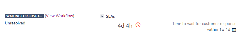

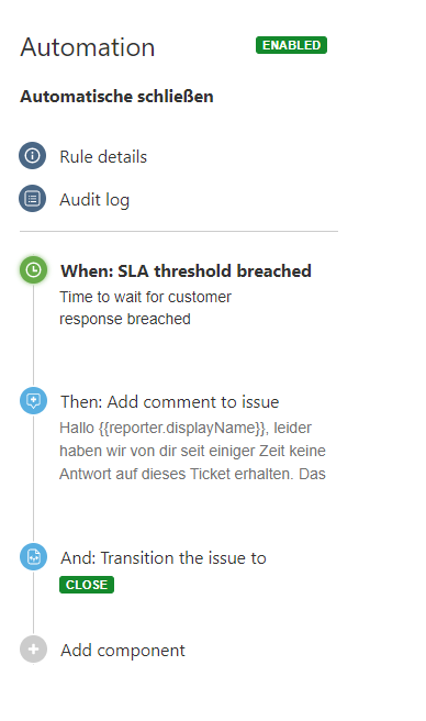

I have a few tickets where the SLA "time to wait for customer response" obviously breached (s. screenshot). I need a project automation using the plugin "Automation for Jira":
IF SLA breached
THEN add comment
AND transition to close
(see  screenshot)
But even though the SLA breached, this automation is not triggered and the ticket will stay "Waiting for customer" forever.
The strange thing is, that this automation is working for most of our issues but for a few not and I don't get what's the difference between those working and not working.

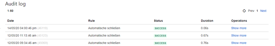

The problem I'm facing with the audit log of Automation for Jira: I can't search for specific issues. I have to search through millions of logs. I can't even filter for error logs.

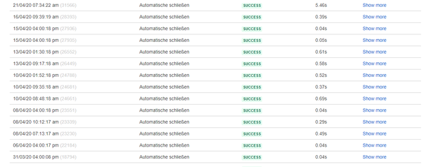

I have a current example from today: an issue with breached SLA almost 3 hours ago:
Looking in th audit logs from Automation for jira: Nothing. The last entry was yesterday afternoon.
