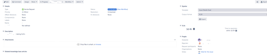

This is a ticket example, where my SLA "Time of First Response" is not displaying:

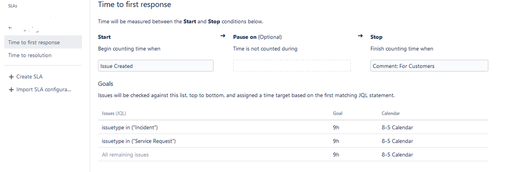

My sla SETUP is this:
I can;t understand, why in some tickets is not showing, and in others it does - same project, same issue types, etc...

This is a curious one. Your SLA setup (while a bit overly complicated) seems fine. Every issue is created so that trigger should fire and you have an All Remaining which would catch any other typo/goal you might have.
(You have the same goal for all issue types and the all remaining, with the same calendar so it could just be the "all remaining one" but that shouldn't cause any problems).

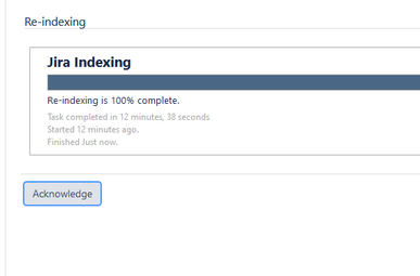

Yes, i have re-indexed the instance:
All fine, no errors, and no, I don't have any update sla link unfortunately ;(

Can you first try to simplify your goals? It appears that you want 9h for any issue in this project so remove the two Issuetype entries. If this does not work then delete the SLA and recreate.
