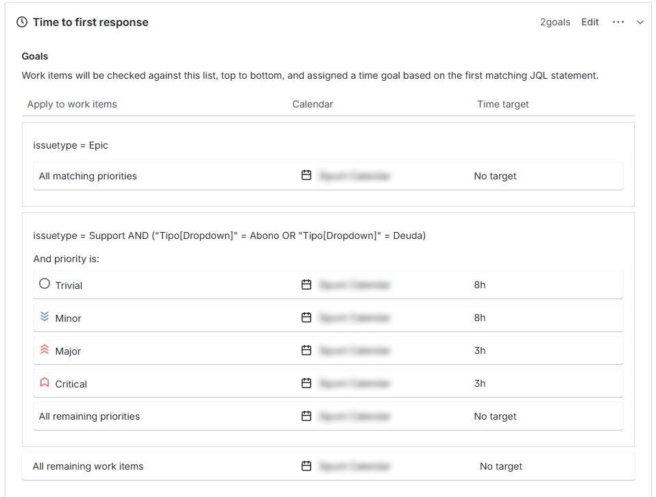

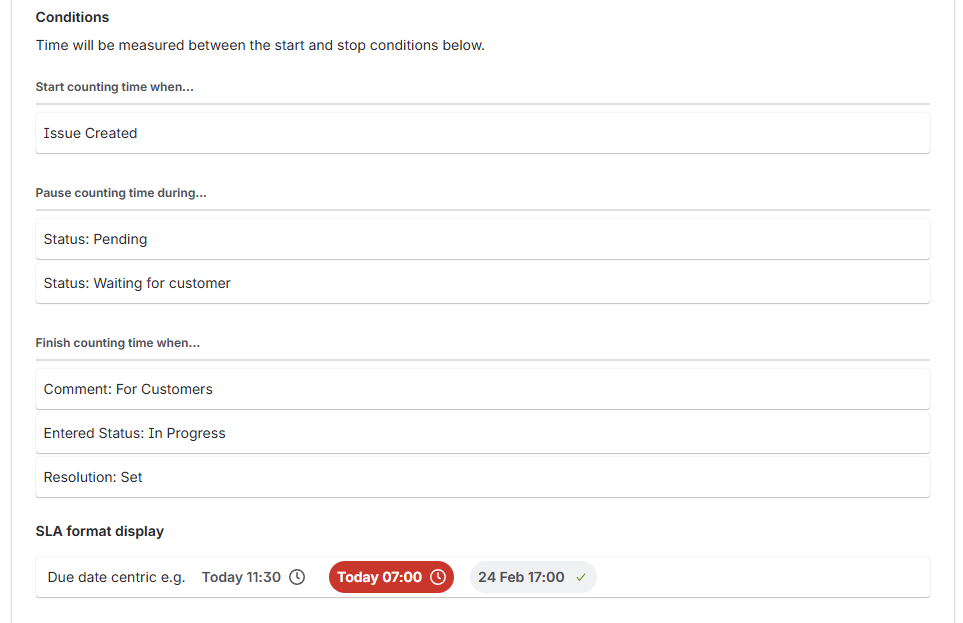

Time to first response
  • Start condition: Issue Created.
  • Pause condition: Status: Pending or Status: Waiting for customer.
  • Stop condition: Comment: For Customers, Entered Status: In Progress, or Resolution: Set.
  • JQL Goal:
    issuetype = Support AND ("Tipo[dropdown]" = Abono OR "Tipo[dropdown]" = Deuda)
    with specific targets for Priority (e.g., Minor = 8h).

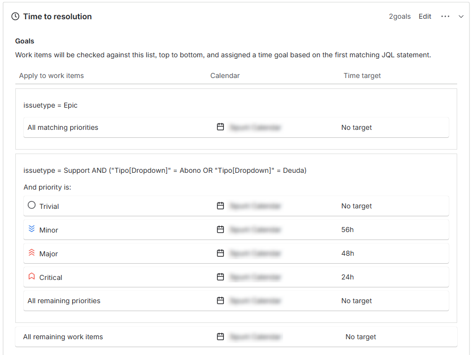

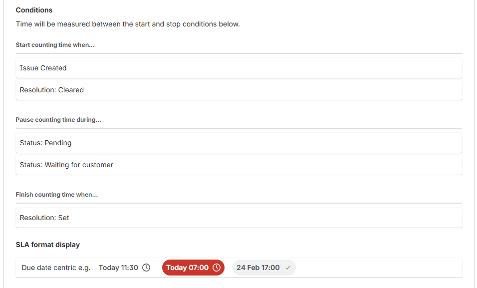

Time to resolution
  • Start condition: Issue Created or Resolution Cleared.
  • Stop condition: Resolution: Set.
  • JQL Goal:

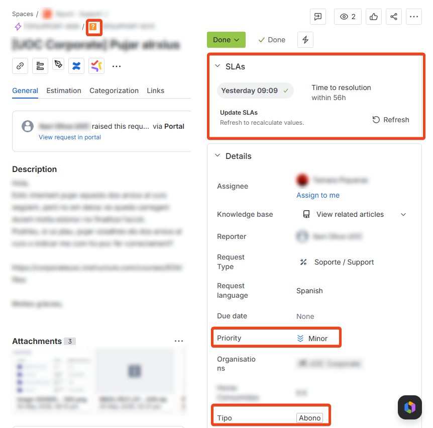

Issue with Time to First Response Missing
  • issueType = Support
  • Tipo = Abono
  • Priority = Minor

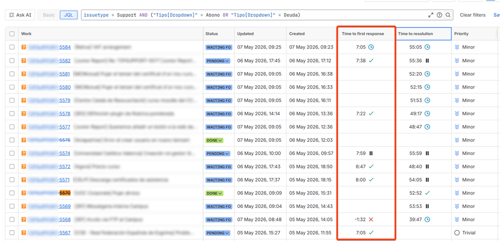

JQL check in the advanced search
Reporters are customers and most of them already have a public comment from one of our agents.

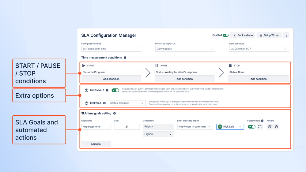

If your team often works with SLA rules based on custom fields, automation, request types, priorities, or different workflow conditions, you may also consider using a Marketplace SLA app as an additional SLA tracking layer.
For example, SLA Time and Report for Jira lets you configure SLA timers with flexible Start, Pause, Stop, and Reset conditions. You can build SLA logic around Jira fields and custom fields, define different SLA goals for different cases, and track the result directly on the issue. This can be useful when native JSM SLA configuration becomes hard to manage because the SLA depends on field values, workflow changes, or more complex business rules.

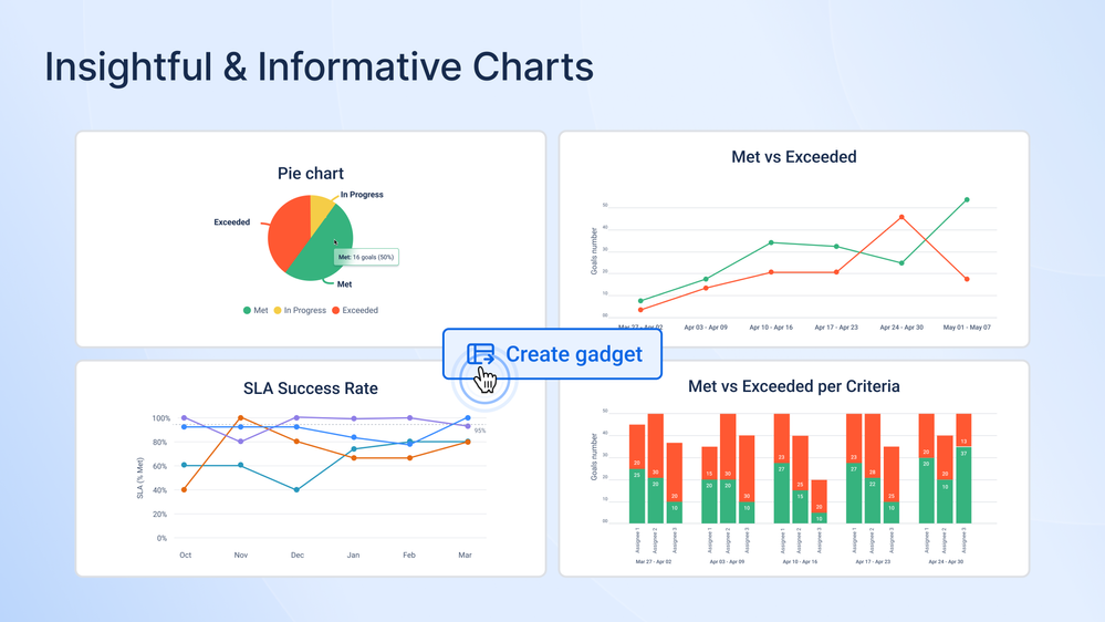

The app can also help with visibility after the SLA is configured: teams can use SLA Grid reports, SLA charts, Jira dashboard gadgets, and alerts to see which tickets are on track, at risk, or already exceeded. So instead of only checking whether an SLA appeared on one ticket, you can monitor SLA performance across projects, teams, or specific SLA goals. SLA-3.png
It will not “fix” a native JSM SLA configuration issue automatically, so I would still start by checking the timing of the Tipo field and the SLA goal logic. But if this type of setup is common in your project, a more flexible SLA configuration and reporting tool may make the process easier to control.
