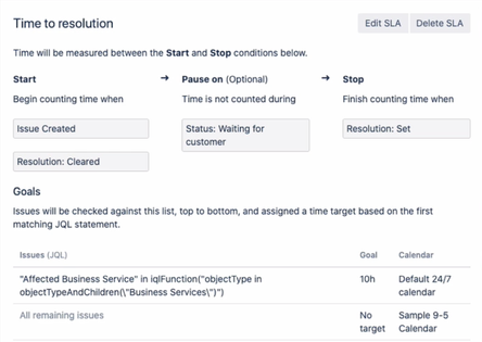

@Aidan Goldthorpehere is a simple SLA configuration.
Maybe this helps. I've created a support ticket for that: SDS-50873

That's very unusual behaviour. It's interesting that both of you observe this with Insight custom fields. Are there any differences in the JQL results after adding a customer comment? Does any other behaviour trigger changing the goal, such as transitioning the issue or adding internal comments?
I suspect the issue is in some way connected to how that particular custom field works, but it would be good to identify the root cause.

no there is no other behaviour. Here are the steps to reproduce:
  • Setup clean Jira Service Desk instance
  • Created project with IT Service Desk Template (ITIL).
  • Install recent Insight version
  • For testing (as it creates the custom field) I've created another project with the Insight provided project template as it creates the schema and custom fields (e.g. affected business service)
  • Create 1-3 test business services in the insight schema
  • I've added the field to the Service Request screens from the IT Service Desk template project.
  • Added my SLA goal as above. Technically the SLA goal for the example will be set if a service is selected
  • Create sample customer
  • Customer creates simle "Get it help" issue from the portal
  • As agent / admin i've adding the affected business services.
  • The SLA will be shown.
  • Customer comments from portal (transition isn't needed) and the SLA goal disappears.
Maybe the problem is the "dynamic" JQL. For example if I change the JQL to be more static like "affected business service" = KEY-123 then I don't have the problem.

I've also created an issue with Mindville and they were also able to reproduce the problem and created a bug report: ICS-1648
