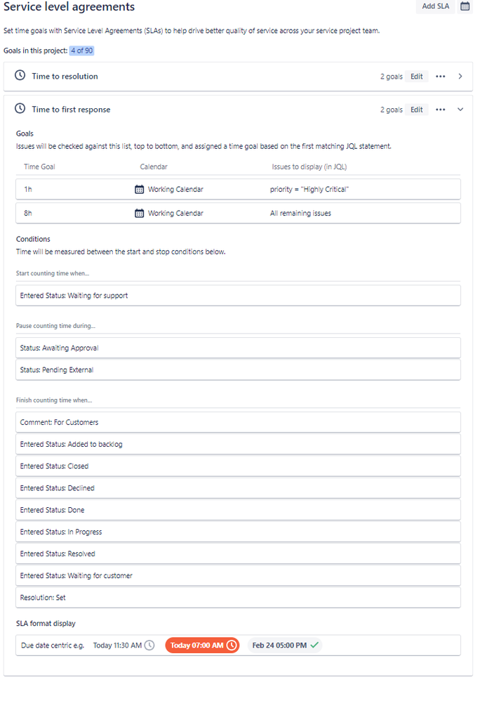

Sometimes, our SLA does not register the 'first responses'/comment IT supporters makes before the time runs out - ticket/SLA gets breached. And SLA should be turned on, because it does functions generally with most cases/most people. Here are the SLA settings:

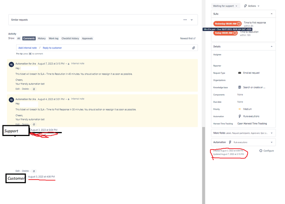

I have attached a specific case with a supporter. Here the supporter already commented/responded, but the SLA keeps continue and in the last end up getting breached.

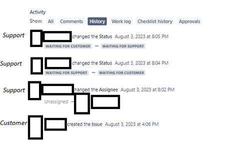

A picture of the history of this specific case:

Looking at the history that you posted, the ticket mover from waiting for support > waiting for customer > waiting for support. So I am guessing that the SLA resumed counting when it was moved back to waiting for support. And since it has remained in that status since the SLA eventually breached.
This is because you are using "Entered Status: Waiting for Support" as trigger. So each time the ticket enters that status the SLA starts counting. To prevent this, use the trigger "Issue Created" instead.
