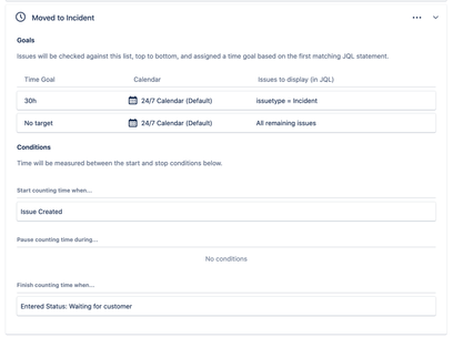

Testing on my local site, I created a simple SLA for tickets of issue type Incident.

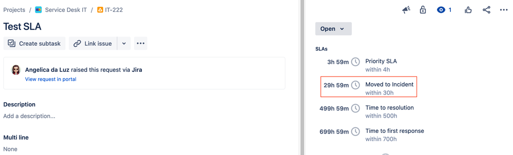

Then, I created a new Service Request ticket and moved to Incident. The SLA worked correctly.

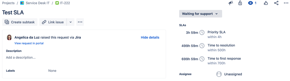

After moving to Incident:
Just for a better understanding of the issue, can you please share with us a screenshot of the SLA configuration?
Also, while you are viewing the affected ticket, open the developer tools on your browser and check the console tab. If it shows any error, please share it with us.
