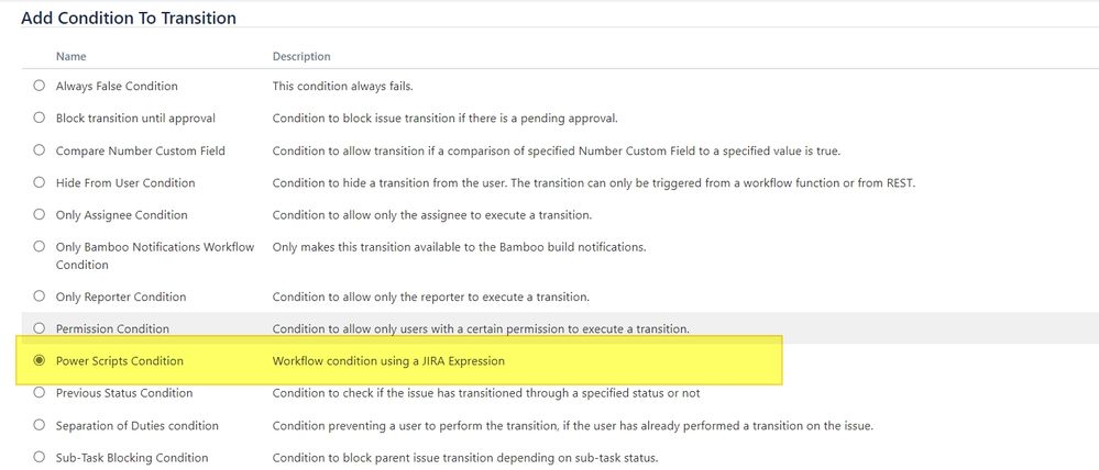

Yes, that`s true, in Power Scripts for Cloud you cannot use SIL script as Validator/Condition. Jira Expressions should be used instead. Please refer to this page to get more information about the differences between Power Scripts DC/Server and Cloud: Power Scripts Cloud Functionality vs Server
Also adding some documentation about how to write conditions/validators for cloud using Power Scripts and Jira Expression Conditions and Validators Cloud

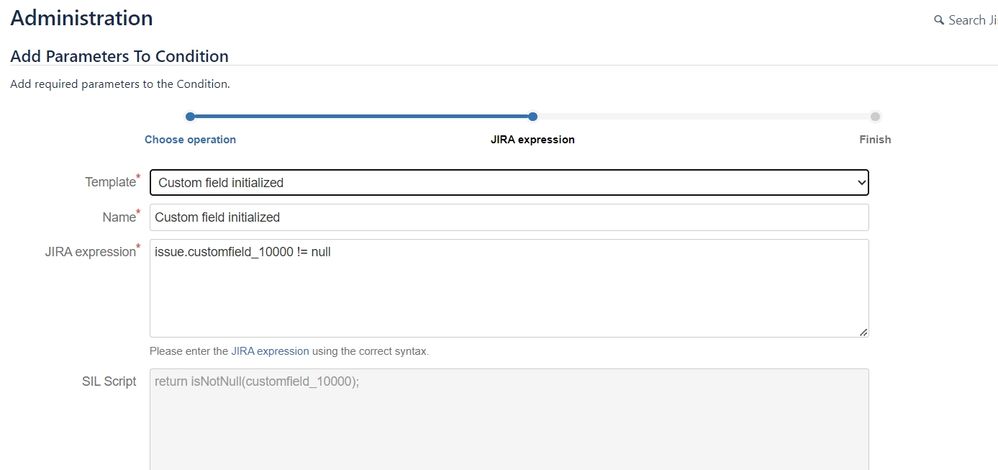

Also, I forgot to mention that for your particular example," validator to ensure that the transition can be performed only if some fields have been filled", you can also use templates that we have both for conditions and validators. For example:
