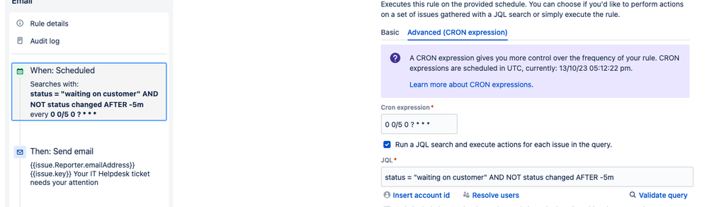

I am having trouble with an automation running. When I click on Run Rule, it is successful and sends the email that I have setup for it. But if I wait for it to run on its own, it is not running. Here is what I have configured. This is just a test configuration to make sure it runs correctly. I have this set to run every 5 minutes if a status has not changed from "waiting on customer".
Once I have the kinks worked out, i will change it to the actual time frame that I want to use. Can anyone tell me what I am doing wrong?

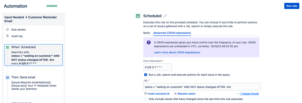

Hey @Jeremy Tatro ~ do you have this option unchecked?
Jeremy Tatro
October 13, 2023
@Laurie Sciutti Yes, that is unchecked
Laurie Sciutti
October 13, 2023
@Jeremy Tatro ~ any clues in the Audit log?
Laurie Sciutti
October 13, 2023
And when you Validate the query, are there any returned results?
Jeremy Tatro
October 13, 2023
Correct.  Here is the screenshot of everything. the rule runs successful if I click the Run Rule button. So that leads me to believe that I have the CRON and and JQL query correct. But it doesn't run on its own and I don't get any errors that tells me why it didn't run.
Laurie Sciutti
October 13, 2023
@Jeremy Tatro ~ Do you see anything in the Audit log, like a "No Actions Performed" entry that you can drill-down?
And is the Rule actually enabled?
Jeremy Tatro
October 13, 2023
The rule is enabled. When I look at the audit log to see if there is anything there that tells me why it failed, there is nothing.  I do see the two success attempts when I did the run rule, but nothing for when it runs on its own.  I am at a loss here.
Jeremy Tatro
October 13, 2023
@Laurie Sciutti Think I figured out the issue.  I changed up the CRON expression a bit and it seems to be working.
