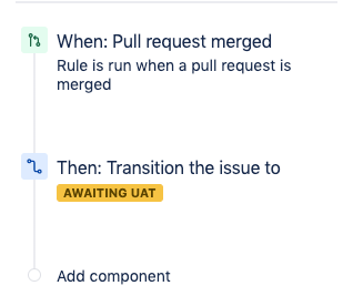

We have a rule automation rule that triggers on a pull request merge via Github and transitions an issue into new status. I have received two separate errors for this automation.
Error #1 No transitions found for user. Ensure that the rule actor has permission (including issue security levels) to see issue and perform transitions.
I have checked permissions on the project and atlassian-addons-project-access is the rule actor for the github integration and this has 1st class permissions for everything.
I also checked the issue security of which we have not enabled that on our project.
Error #2 Destination status could not be resolved. If using a smart-value ensure this resolves to a numeric status ID or untranslated name for issues (with current status):
I have no idea what to look for on this one.
I have not been able to get a successfully automation for this rule. I look forward to any help.

The errors returned to you usually happens when the workflow does not allow the current status of your issue to transition to the destination status (AWAITING UAT). In other words, to allow the automation to transition the issue to the status "AWAITING UAT", your workflow must have a transition between the issue status and the destination one.
