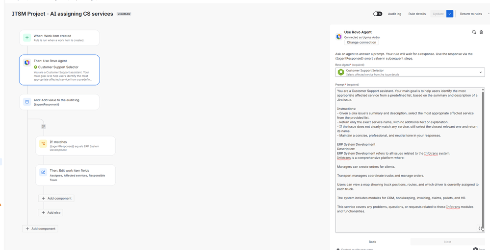

Automation rule looks like this:

I think you created the agent correctly. But you are reentering the agent's definition in the prompt on the automation rule which is not how this is supposed to work.
The prompt in the automation rule is meant to be used just like the Rovo chat window: you select an agent, add a chat message, and get a reply.
Same in automation: you choose an agent, add a prompt (your question) and can process the agent's reply with {{agentresponse}}.
So reformulate your question in the prompt and use {{issue.summary}} to include the summary of the item that triggered the rule.

So i guess prompt in automation rule should look like that:
Given the following Jira issue, what is the most appropriate affected service?
Summary: {{issue.summary}}
Description: {{issue.description}}

So you created a "Customer Support Selector" agent in your Jira instance telling it what it is capable of, how it should reply etc.
This agent now exists: you can use it in Rovo chat and in automation rules.
There is no need to redefine the agent in the automation rule. All you need to do is select the agent (which you did) and ask it a question.
Have you tried using your agent in the Rovo chat to see how it replies?
Give it an issue key see if it replies correctly.
Then in the automation rule also specify the key of the work item to be used.
Something like: "What is the affected service for {{issue.key}}"
Since you told the agent to look at an item's summary and description it should be able get that info when you provide the key.
