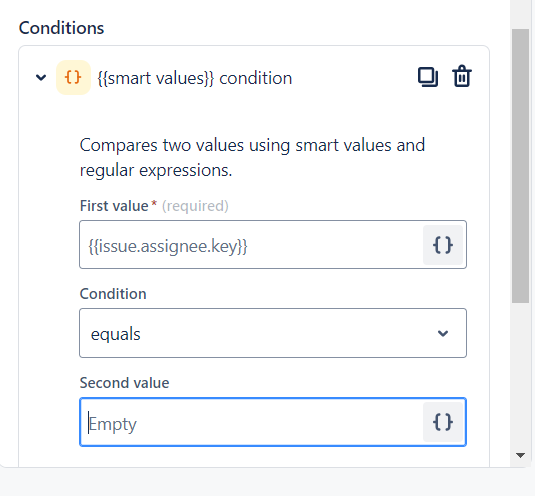

Actually you can use Automation setup against Cascade select field data type.  What you will need to use is the concept of SmartValue in automation + the condition testing will be based on "smart value" conditions (also previous known as Advanced Comparison condition)  to test for the criteria
For the parent value -
{{issue.customfield_xxxxx.value}}
For the child value -
{{issue.customfield_xxxxx.child.value}}
Once you try it out, you should be able to setup the necessary actions to fire when the conditions match.

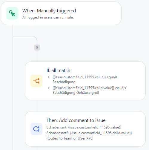

I have a Request Type which is using an cascading for type of damage (Schadenstyp), which is customfield_11595.
2024-06-10 22_33_48-Audit log - Automation - Depot Support - Jira und 5 weitere Seiten - Geschäftlic.png
So you can simply add the combinations in an if/else and choose the actions you need.
Would be nice to have a second if/else level, but we do not, so you have to run through all combinations you have and add the actions you need.
