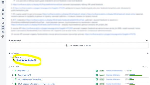

I installed Jira Server 7.13 and Confluence 6.15 on same Ubuntu 16.04 machine and connected them together.
The problem is that links to confluence pages with cyrillic symbols corrupted by rhombus symbols. Problem appears with Cofluence links in "mentoined in" block only. Links to other Jira issues display correctly.

It seems like encoding issue in Jira. Take a look at this document. There is a recommendation from Atlassian on using UTF-8 encoding when starting Jira.
Start JIRA with the parameters -Dfile.encoding=utf-8 and -Dsun.jnu.encoding=UTF-8

Thanks! Your suggestion eliminates problem.
