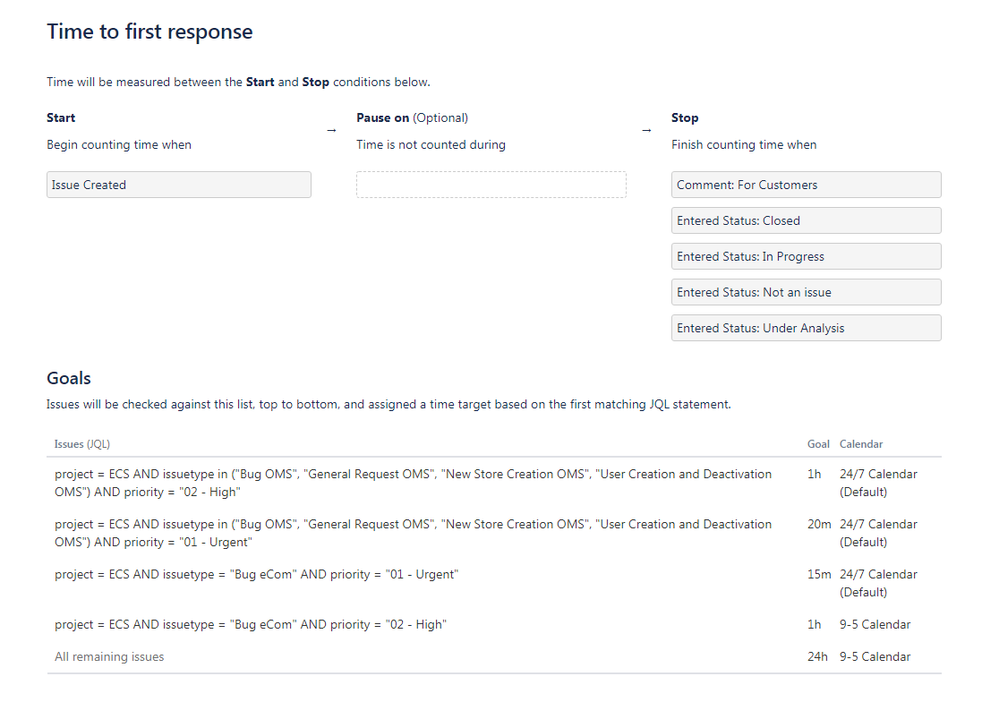

Can you send a snip of your SLA? I'd like to take a look. I *think* I know the issue.
Gabriel Viger
March 12, 2018
There you go.
Thanks again!
Meg Holbrook
March 12, 2018
I think the solution for you will be to create a new transition step for escalation.
Your 'start' criteria is not changing, so all you're doing is telling the SLA that it has a tighter timeframe than before, but not 'restarting' it.
Try to create a workflow loop 'Escalation' by transitioning from your start status to your start status, and add a trigger that the priority will update to p2.
