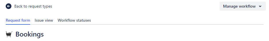

At the moment our solution is to not put the field in request types - request form tab, but to put it in our request type - issue view tab. (Below the request type tabs shown)
This way, we still cannot make it required, but at least it is not visible when creating issue (for customer), and our support team can still fill it out when resolving an ticket.

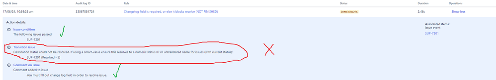

I tried to make an automation as you said, but I got errors on it.
Here is how I made it:
When transitioning from one of the statuses, showed in the first bracket --> and the field (changelog) is empty ---> it should be transitioned back to waiting for support and add a internal comment to inform IT Support that they have to add certain info in field, when resolving issue.
Audit log:

Regarding your use of automation, I did not recommend trying to use Automation. I mentioned using a Rule but that was in the context of modifying a Team Managed project workflow. In TM projects the team "Rule" is used instead of "Conditions" or "Validators" for the limitations you can add to a Workflow Transition.
