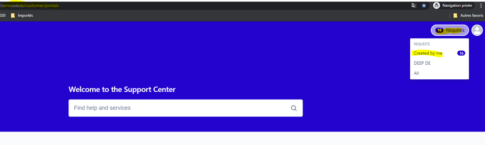

I am experiencing following issue on JSM cloud :
  • Login to Portal as Portal User (Customer)
  • I can see that we have few open tickets

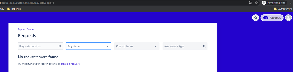

  • Open Requests list  created by me
  • the Portal reports: "No requests were found"

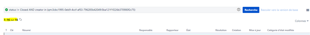

Do you have access to the backend too? I believe I noticed the same behavior when the issues have a security level set on them but the customer role is not part of that security level.
Any chance you can do a filter on the Agent side (e.g. Reporter = yourname) and check one or more of the issues?
Yassine_HADDAD
January 5, 2021
@Dirk Ronsmans Yes i have access to the backend
And when I do a filter on the agent side i can find all the requests image.png

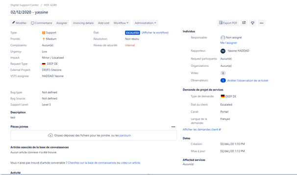

Can you open one of them and see if there is a security level assigned to them?
Normally that shows as a padlock in the top right corner (on the new issue view)

I can't find the padlock

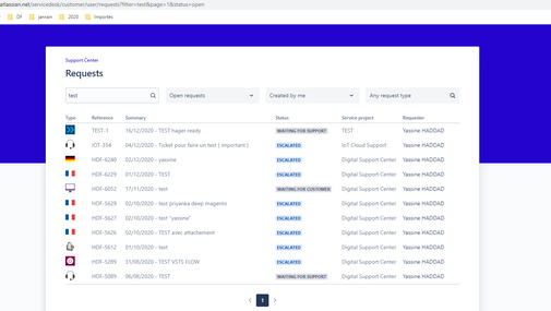

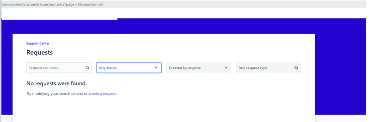

For me the issue it be can in the filter request , because also if i change the filter like her i can't find any think
But if i put something in the request contains like test i have a result

The padlock is only visible from "new issue view", you are clearly on "old issue view".
But it does not matter as there is something important visible anyways from what Dirk already anticipated.
Noveau de securité: Internal
There is a Issue Security Level set.
