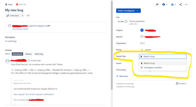

When I have a support ticket in my queue and enter a ticket to change the "request type", the options available ("report a bug" and "investigate a problem":

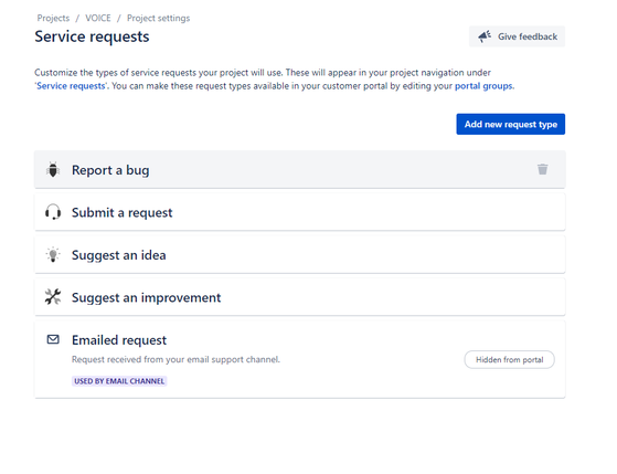

are not the same as the ones I have created (four below):
Why can I not choose from the four request types listed above on my ticket?

Please check what issue types are linked to request types which you don't see on the dropdown. I guess that they use different issue type, so this is why they're not listed. If you move the request to another issue type, options in the Request type list change.

Hi Kate, okay, thanks. In Project Settings -> Request Types I can see that:
REQUEST TYPE                  = ISSUE TYPE
Report a bug                      = bug
Submit a request                = widget request selector
Suggest an idea                  = amend existing
Suggest an improvement   = New suggestion
So nowhere is listed a request type "Investigate a problem"... Could the field in the support ticket be using some default request types built into Jira rather than the four I have created above?

Are you 100% sure that you check correct configuration? VSD is from Voice project? Because it looks like somebody change the name of request type.
Do you use translations? Maybe somebody tested them and made weird translation "suggest an improvement" - "Investigate a problem"...

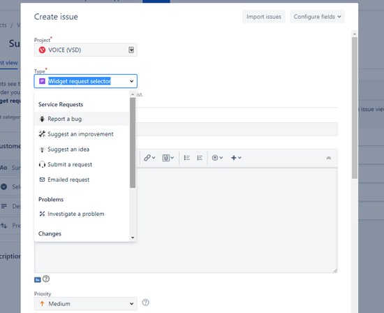

When you open Create Issue dialog (in Jira, not on the portal), what Request types do you see in the Type field?

When I choose "type" from the dropdown it seems like it's taking the first item from "service requests" and then the first item from "problems"... whatever that is?! It wouldn't be something to do with Screens, would it? I haven't really touched those.... Where is it pulling "problems" from?

Thanks for the screen. It helps :)
Investigate a problem is not defined as a Service Requests - this is why you don't see this option on the screen which you uploaded at the beginning (from configuration). To find Investigate a problem, you have to go under Project settings > Request Types > Incidents.
In case of dropdown, only Report a bug and Investigate a problem use the same Issue Type. When you're in configuration, click on each of them and check in the Agent view or Request form what issue types are used (For example: Agents see these fields when they work on a customer's request of this type. Drag and drop to order your fields. To add or edit fields, go to the View issue screen for issue type [System] Service request.)
