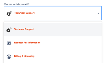

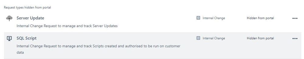

I have set up Request Types under the Internal Change Issue Type. I have hidden these Request Types from the Portals, as they are intended to be used as internal changes only so should not be visible to the end-user.

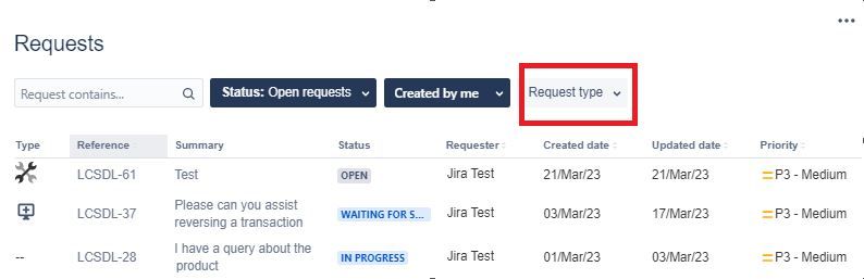

While the Request Types are not visible for the customer to raise themselves, they are still visible when the customer goes to Requests, then uses the Request Type drop-down menu.
The 'Hidden from Portal' does not do what I would expect it to.
Does anyone have any ideas?
Below you can see the types visible to the customer.

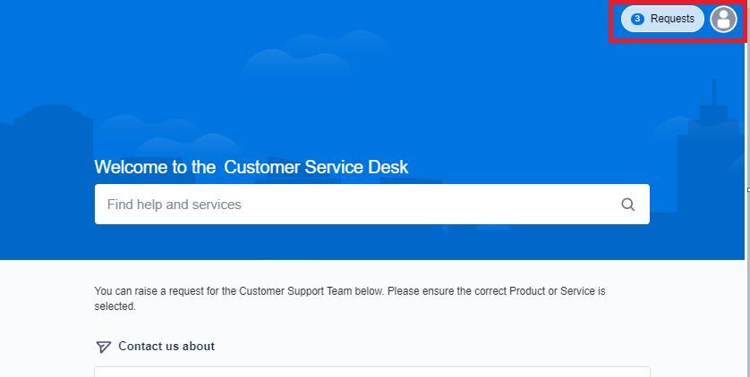

Where that screen shot is taken from is here, under Requests.

Aha, in the customer request overview. To be honest, I haven't noticed this before but it seems that this is unwanted, to say the least. You can also see all the workflow statuses over all the different projects, something which shouldn't be the case as well in my opinion.
