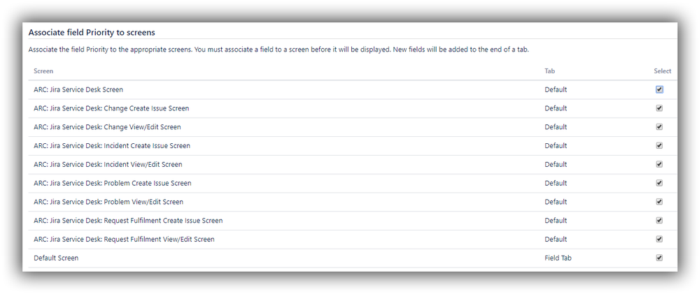

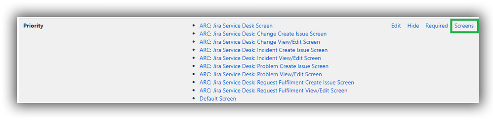

Please don't worry about my question, I have finally figured out where you were going with it.
I somehow kept missing the 'Screens' option in the 'Field Configurations' Section.
For anyone else's reference, please check as Daniel has described above, the section that he is talking about is located at:
JIRA Administration Cog --> Issues --> Field Configurations --> <<Select the Field Configuration of your choice>> --> Check each field via the 'Screens' action on the right hand side.
