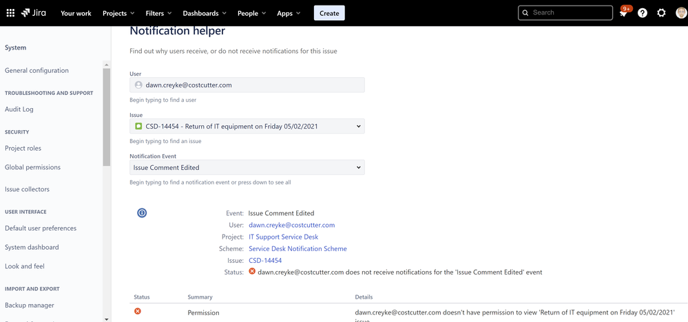

I have used the Jira Admin Helper (Notification Helper) and it came back with the below:
We have recently added an Issue Security Scheme, as we wish to restrict access to particular issues for particular groups of users, so suspect that this may be the cause?

Judging by what the helper is throwing back I would think that to be the case yes.
A Request Type for example is needed when you want the tickets to show up on the portal for that user but I'm not a 100% it's also needed for the notifications. As these are created through email it should already have a default Request Type linked to it anyway.
Since the helper is complaining about the permission that would make sense. Is that person the reporter of the issue then? If so, I'd suggest adding Reporter and possibly also "Service Project Customer - Portal Access" to your security scheme.
It makes sense that if they are not allowed to view the issue in any way they would also not get notifications as you cannot control what they do with the information of the notification.
I would look towards that direction.

We have temporarily removed the Issue Security Scheme and Reporters are now receiving notification emails again!
We shall heed your advice about adding 'Reporter' and 'Service Project Customer - Portal Access' to the security scheme when we try again with restricting access ... so not everyone is affected! 😉
