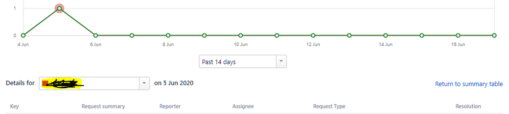

Report issue.PNGissuetype in (standardIssueTypes(), subTaskIssueTypes()) AND status = Resolved AND "Request participants" in (X, Y,Z) AND assignee in (X,Y,Z)
I am using this query in a custom report, but only the Request participant is not showing in the column. Could you help me to find out the way.

The name of the columns on a report is based on the Series, so if you meant that Request participants are not showing it's because a Serie for that was not created.
If possible, share with us a screenshot of the entire report, showing the series so we can better understand and test here using the same options.

What data a report shows is up to the report.  What report is it and what do you mean by "request participant is not showing in the column"?
By the way, your query can drop the issue type clause - the query you have there comes out as "all issue types"
