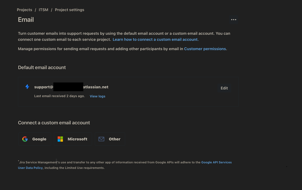

Thanks for your quick response Brant, however the issue is I don’t want to use the custom email across the whole project. I would like mainly to use it for the creation of issues from the email.
It was created on Project - Project Settings - Email Requests. It doesn’t mention anywhere on this screen that the email connected will be your default Reply To. Screenshot below.
I don’t see it being a problem if the reply to mailbox is the custom one if it was issues that were created by someone sending in to that Mailbox or even the same Request Type.
But as mentioned this it’s only own on emails that are not asssigned to anyone. The ”Created Emails” were sending from both emails.
