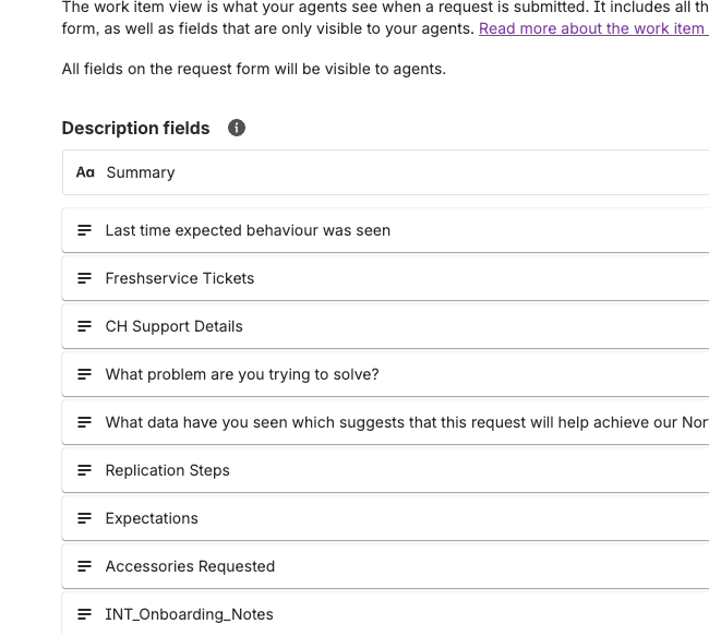

Somehow someone added a bunch of fields to our Service Desk work item view. Just dozens of work items that are meaningless in the request context but get added to every request. There are hundreds of custom fields associated with the screen scheme, but show up as 'hidden when empty' and I don't see how these are different.
We have probably 50 service desk request types, and I don't want to have to manually remove all of them from each request type.
Somehow they got added to all the requests at the same time, but I don't see anything in the documentation about removing them from all requests.
Also: How did these get added to the work item view, so I can try to prevent this in the future?
Possibly related solution: is it possible to get the request type to completely ignore the work item view?
Any suggestions? Thanks in advance.

That can happen a couple of ways, if you are creating Request Types using a template versus from scratch, Jira will add a bunch of those. I NEVER use a template. Or when people create custom fields, they might choose to add it to all screens. Either way, it's not good.
Instead of altering the field/issue layout, you should go to the screen itself and remove the fields there.

Each one of these weird fields is actually a valid field for ONE of the Request Types, so I can't remove them from the Screen or they won't be available the one place where they are actually needed. That's why I think it is important for me to understand how they got added to the Work Item View and how I can remove them from some sort of Work Item View configuration (not just the Work Item View tab for the request).

In that case you should create a different screen and screen scheme for each issue type. Then you can remove the fields from the screens associated with the issue type associated with the Request Type.
Or
You can update the Context for each of the Custom fields to be associated with an Issue Type. This will cause them to disappear from the screens for the other issue types.

Actually, I tested adding a context to one of the problem fields, and it did not remove it from the forms for the other request types. Not sure how to proceed other than just manually removing them. Frustrating.

This usually happens when new custom fields are added to a shared screen scheme or request form configuration that’s used across multiple request types in your Service Project.
Here’s what’s likely happening:
  • Those fields were added to the “Edit/View Issue” screen or the Agent Work Item View that’s shared among several request types.
  • Because the screen is shared, all request types that use it automatically display those fields.
✅ To clean this up efficiently:
  1. Go to Project settings → Request types.
  2. Pick one of the request types that has those unwanted fields.
  3. Click Edit fields (or “Request form” if you’re in the new experience).
  4. You’ll see all fields that are currently on the form — remove the ones you don’t need.
    • The same configuration may be shared by others, so updating one can impact all that use the same screen/form.
If you want to avoid this issue in the future:
  • Create separate screens or forms per request type (instead of using the default shared one).
  • When creating new custom fields, don’t associate them automatically with all screen schemes.
    You can customize this during field creation under “Screens”.
Unfortunately, there’s currently no bulk removal option for fields from all request types at once — this has to be done per type or per screen association.
If you suspect it was added by a global screen update, you can also check under:
Jira settings → Issues → Screens → [Screen Scheme Name],
then remove the fields directly from the screen that’s shared by all Service Desk request types.

I tried your method to clean things up efficiently, but the items I want to remove are not on the Request Form tab, they are on the Work Item View tab. That's the problem. Removing a field from the Work Item View for a Request Type does not remove it from other Request Types.
