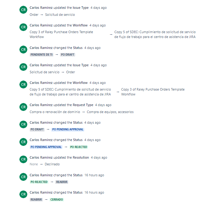

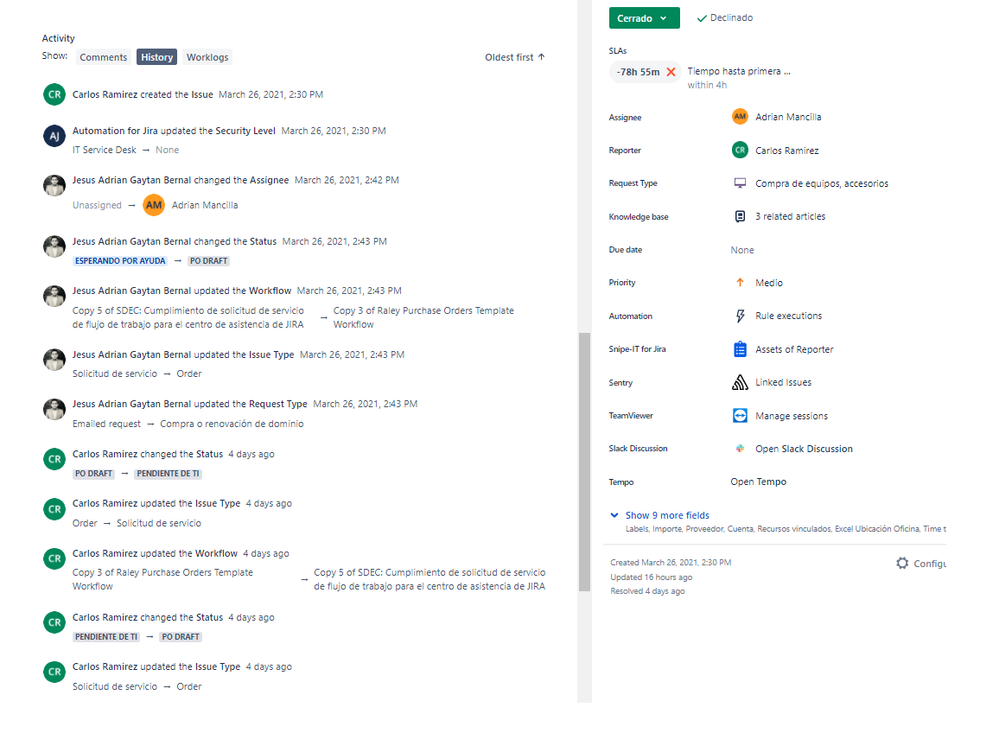

Carlos Ramirez
April 13, 2021
Sure,
Thank you.

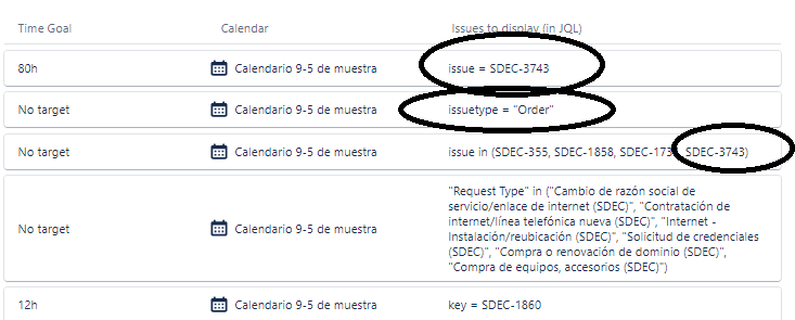

Carlos Ramirez
April 14, 2021
Hi Gokce,
Since the beginning of the service desk, for this type of issue that is an "order" I set up with "no target".
For this situation, first I set to "not target" the specific issue in the third row, but it doesnt work.
Next, I set in the first row with 80 hours and doesnt work.
Its strange this case because as you can see, I have some issues in third row that I need to change with no target when I make some test.
This SLA is for the first time response.
Thank you
