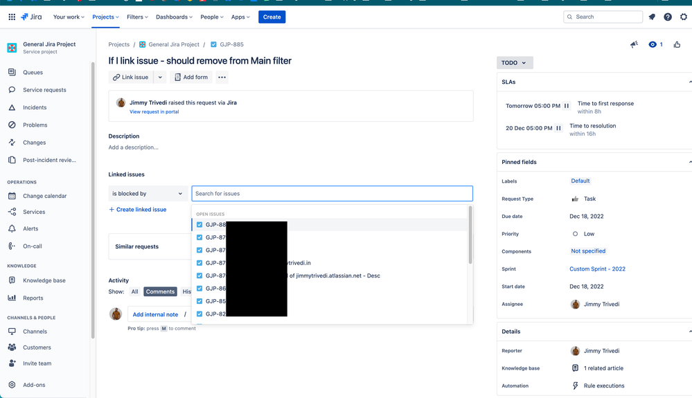

So, I use Service Project, and I use Filters as well. Please see below:

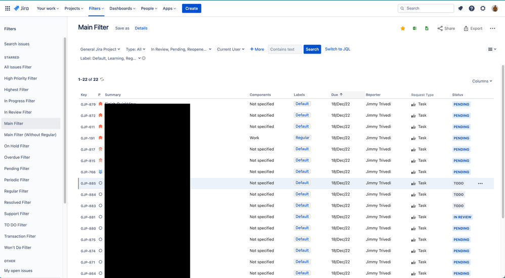

Now, what I want is, in this same Filter [let's discuss about Main Filter], I created 4 issues: Issue A, Issue B, Issue C and Issue D.
So, in my Main FIlter list of all 4 issues are showing, now If I open Issue C and click on link issue and select Issue A, then from my list of Main Filter Issue "C" should be removed, but If I open Issue A, then Inside Issue C should show as "Linked"!

This is my JQl
project = GJP AND status in ("In Review", Pending, Reopened, TODO, "Work in progress") AND labels in ("Default", Learning, Regular, Support, Transcation, Trending) AND assignee in (currentUser()) ORDER BY due ASC, priority DESC
But I don't understood where to add.
Also one important point: You said this: "The above will return all issues which do not have linked issues with them." But that is not the requirement which I mentioned in question. If One issue is linked with other, but there might issues which are independent and not linked with anyone, so that also should come in the filter list.
