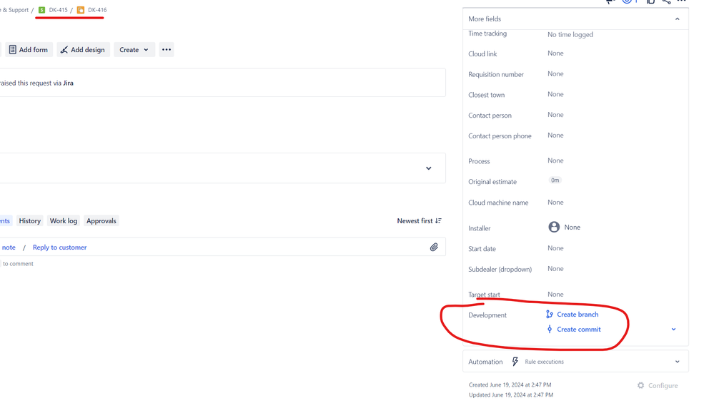

I have spent the last two hours googling and trying out stuff, and I feel like this should have a very simple solution, but I have not been able to find an answer to it..
I have the following subtask. I want to remove the Development field. This field has zero, nada, absolutely nothing to do with this project and for the life in me I can't figure it out. This is a service project in JSM, it has nothing to do with software..

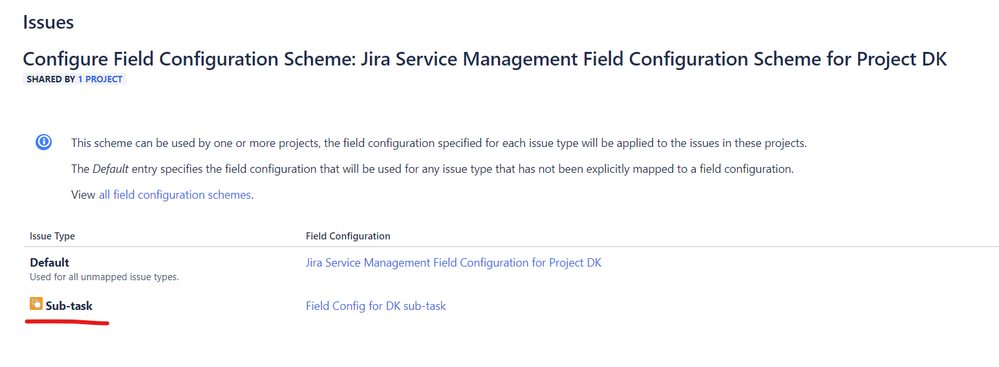

Ok. So I have tried adjusting the field configuration scheme for this project. I have made a new field configuration for this issue type.

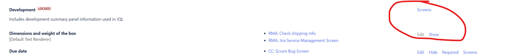

This somewhat works. I can "Hide" certain fields, but not all. This being one of them. Why Jira? Why?

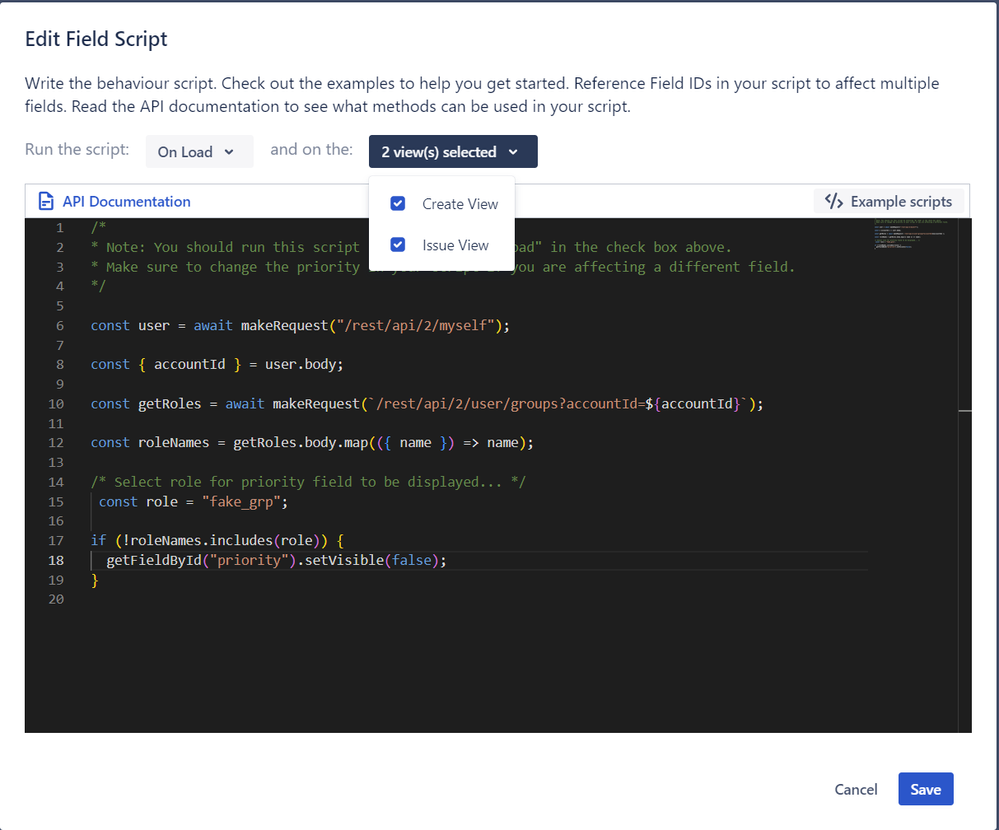

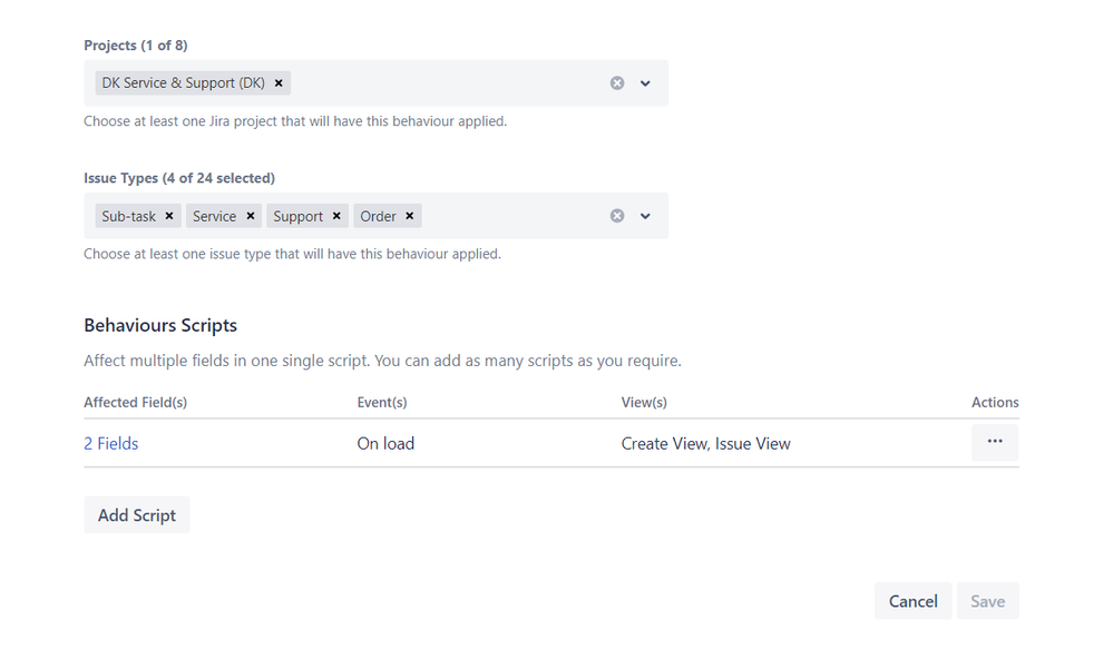

One other thing I have tried and is not working is using Scriptrunner's Behaviours. I don't want anybody to see that field (and a few others but it's a good start). I have made a fake group that does not have anybody in it. I have created a behaviour (in the screenshot below I was testing the standard example script, with priority, unsuccessfully...

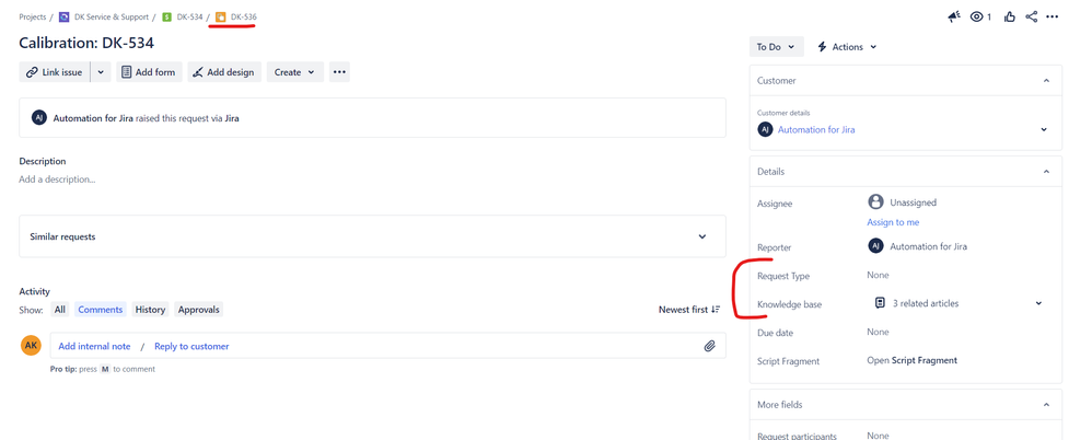

Do you have an idea how I could remove the Request Type and Knowledge base also?
The request type makes no sense, as a subtask can not have it, and we don't need the KB either.
Request type is locked also..

I'm afraid not. This is more project-wide engrained and I can imagine you actually do want to keep using Request Types and KBs for the actual Service Mgt tickets :)
