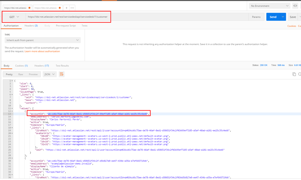

 So I would suggest double-checking the account id's that you are inputing and you can do so via the Get customers API endpoint, noting that this one is currently Experimental as well and requires the additional header noted above:
And one caveat to this one that may be the issue you are encountering is that the accountID value that is returned in this GET, currently will return any colon character ":" with the "%3A" encoding but it needs to be converted back to a ":" for use in the DELETE call.

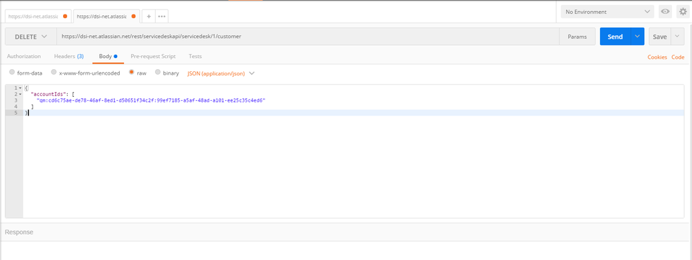

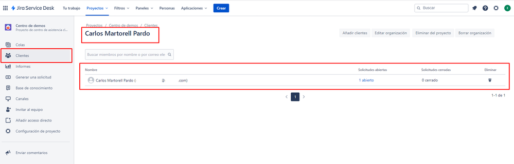

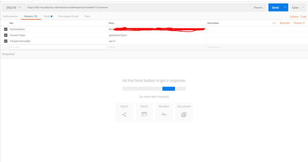

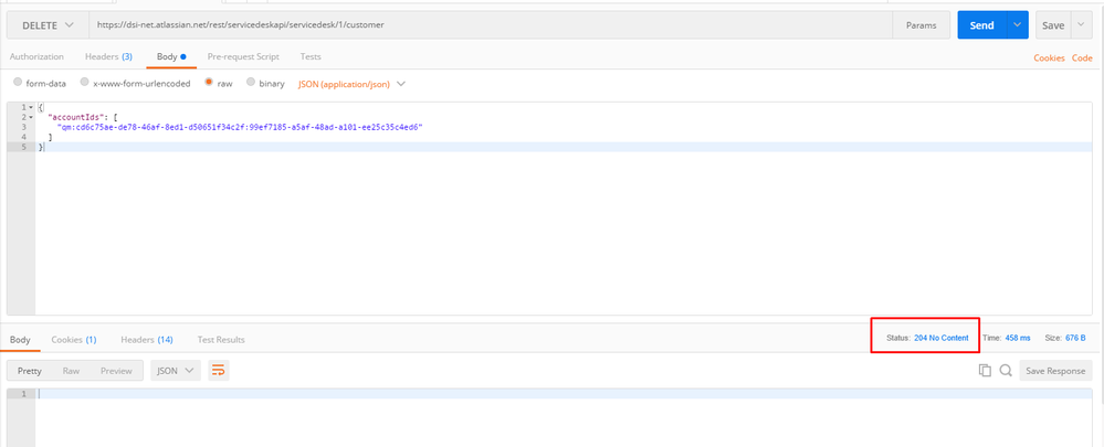

Thanks for the response but i still having the same problem after doubleCheck the account Id, i'll share some screenshots for more info, in order:
- Customer AccountId : qm:cd6c75ae-de78-46af-8ed1-d50651f34c2f:99ef7185-a5af-48ad-a101-ee25c35c4ed6
- Delete customer request header
- Delete customer request body
- Request Result
- Customer still appears on the serviceDesk
