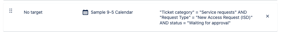

We have a new request type that requires approval before the ticket can be actioned.
Despite having setup what I thought was a 'No target' entry in the Time to First Response SLA for the request type, it still requires a response within 2 hours, the same as the rest of our service requests (this request type uses 'Service Request with Approvals" for the issue type)
Any ideas?
Thanks!

Hi @Andrea Vail
It's kind of hard to tell why it's still getting a 2 hour response time without seeing the rest of your SLAs.
However, to achieve what you want, you should have a condition on your SLA to Pause when in Status "Waiting for Approval".
Suzi

Thanks Suzi! We had missed adding the pause condition for the First Response (though added to the rest of the SLA config!).
