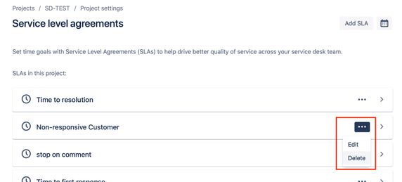

Interesting question Liam. I have never attempted but you can certainly delete SLAs.
Project settings > SLA and click on the ellipses (see below). Now the question becomes will you be able to reuse the "manager alert" field. I think so but you will need to test it out. As you are likely aware some 'delete' or 'rename' actions seem to leave remnant objects in the DB.

I've deleted the SLA - and checked it isn't in any other projects, but the field remains (and is locked) in the custom field list.

To my knowledge, I think currently there is no feature to delete individual SLA custom fields. The "Delete" option in the screenshot you have attached removes the association of the SLA custom field with the project.

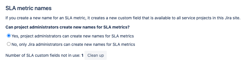

However, there is an option for Jira Admins to clean up all unused SLA custom fields (in Jira Cloud at least) once you have unassociated the SLA field from all projects it is associated with.
If you can access Jira Settings > Products > Configuration (under Jira Service Management) > You should be able to use the "Clean up" button showing in the following screenshot to remove all unused SLA custom fields.

The option for cleaning up unused custom fields also exists in the server edition.
It can be accessed by the Service Management Configuration.
