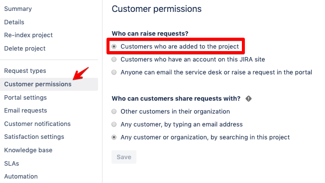

In the JSD project admin settings, there should be a section called "Customer Permissions" - choose this option and change the "Who can raise requests?" value to "Customers who are added to the project."
customer-permissions.pngThen, just make sure no users are in the "Service Desk Customers" project role. This should hide the project from the customer portal entirely.

I have that set, and I had when I added people to the project as read only they appeared in the customer section of the service desk. Do they also need to have the agent enabled to so it clears them from the customer view?
Alex Christensen
December 5, 2019
Granting a user an agent license does not prevent them from seeing the customer portal. Agents are able to see both the portal and entire project.
Basically, if you have any agents on the read-only project, those users are going to be able to see the customer portal, too. Visibility for everyone else, however, should remain hidden.
