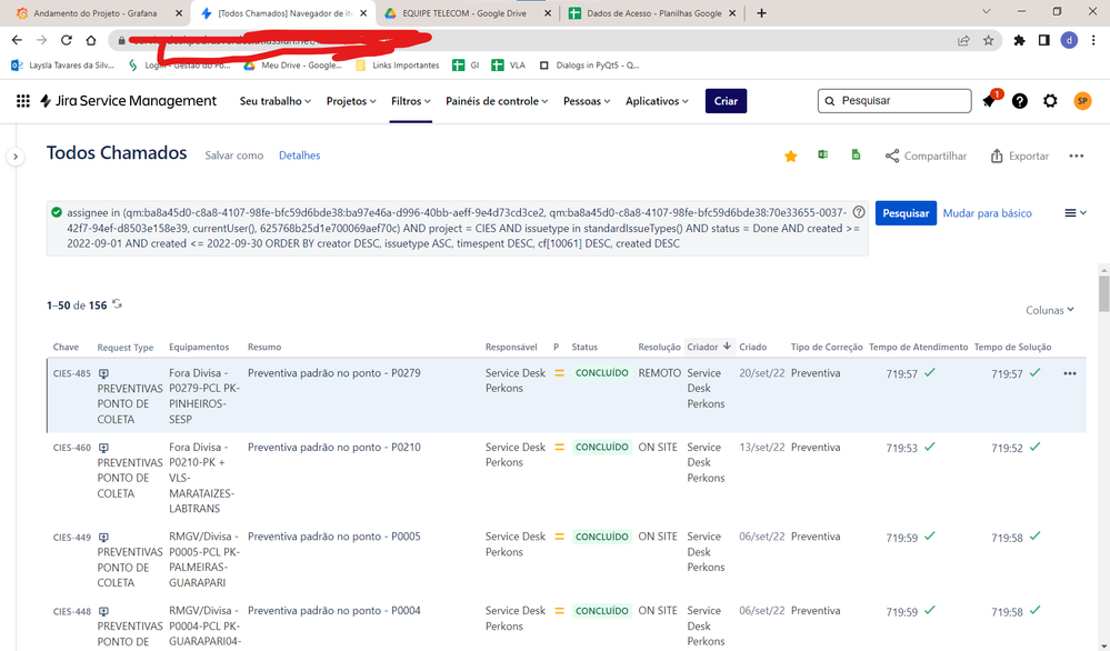

I'm an administrator of jira end i want get this filter (below) by rest api, can i do this ?
I tried by this end point:
"/rest/api/3/search"
"jql": "project = 'Cerco Inteligente ES' and created >= 2022-09-01 and created <= 2022-09-30",
my desire it's return my fields, according the columns of the filter

@Service Desk Perkons and welcome to the community,
The response from this endpoint will be all available issue fields and not by columns you want. That's what's written on their API at least: https://developer.atlassian.com/cloud/jira/platform/rest/v3/api-group-issue-search/#api-rest-api-3-search-get
I don't know any endpoints to get exactly what you want. But what is the exact problem of receiving more fields?

Hello,
I had a doubt when i received the json, i has a varied quantity of custom fields. I can't find this fields on json response.
If i don't send in post query field's, he return all fields ?

Hi, everyone!
Alex help me find the answer, i remove from post the data fields! Now all fields ar lists to me.
Try something like the following:
https://YOURDOMAIN.atlassian.net/rest/api/3/search?jql=filter%20%3D%2010022&expand=names
where 10022 is the ID of your saved filter.
