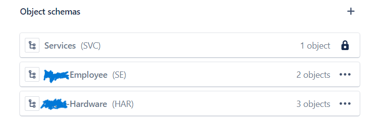

@Dirk Ronsmans, Is Atlassian has some video reference ? I've done these, what you suggested, but the thing is that I'm kind of clueless.
For Example, I'm attaching an img; here, I want to connect the employee object schema and the hardware object schema. And one more thing here, I'm unable to see all these object schemas tougher as a graph view.
Please guide me.
