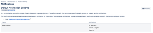

    The notifications about issues created can be configured under project settings > Notifications, making sure the user is under one of the roles in the Issue created notification:
  2. Somebody select him in the assignee field
    About the Assign notification, it is also configured under Project settings > notifications, so make sure the user is under one of the roles in the Issue assigned notification
