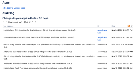

Hello @t_hsaleem,
When an add-on is uninstalled or failed to be updated, it will be registered on the Audit log on Apps > Manage apps. Only Jira administrators are able to access this menu.

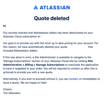

Also, an email is sent to the billing contact informing them that a quote was deleted.

hmnaqvi
November 22, 2020
Dear @Angélica Luz
Thank you for your response. As mentioned by Husna, we've come across a situation where 2 of our installed apps were uninstalled and we are unable to identify if it was by Atlassian due to pending payment or from one of the administrator from our team. As per the logs, we do get a name as to who uninstalled it but since all the development work has been done with that ID, so we're still not sure if that person has uninstalled it or atlassian uninstalled it due to payments for which we are already in talks.
Thank you.
Angélica Luz
November 24, 2020
Hello @hmnaqvi,
As the logs show a name, it means that the user manually uninstalled the add-on. Atlassian wouldn't remove an add-on on behalf of the administrator.
