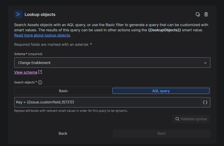

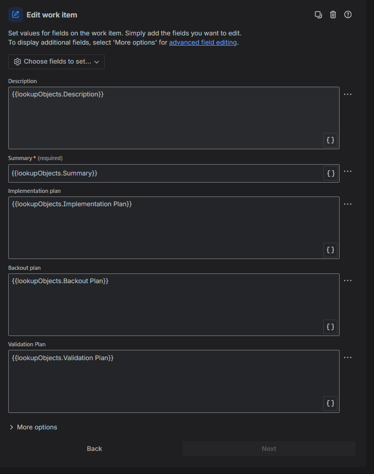

Hi Lindsay,
Similar to what Jeroen mentioned, I assume you have a custom field that stores the asset as that is a requirement.
I currently use the 'Lookup objects' action to grab details for a specific asset.
Hi Lily,
This will work but are actually a few obsolete steps.
When you have the object in an asset field, you don't need to retrieve the asset separately, you can access its attributes and the ones from referenced assets in one go via the syntax mentioned above.
