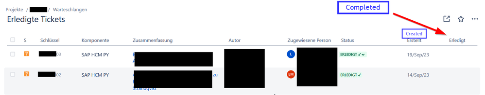

Hello Community,
I have created custom queues in a project. I have sorted them by open, waiting and completed tickets. There is a queue for "All completed tickets" and there is one with "My completed tickets". In these two queues, I want to have the tickets sorted by completion date. When I edit these queues and add the "Completed" column, there is no date in the column. How do I make the completion date appear and sort the tickets by it?
Thank you very much in advance.
Many greetings
Stefan

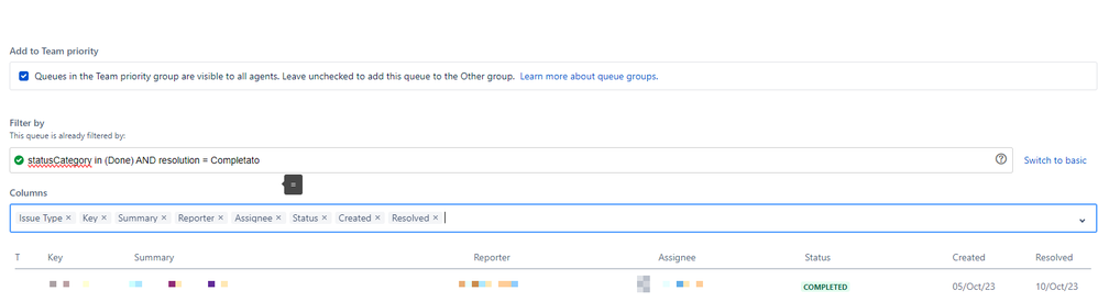

Valerie Knapp
October 11, 2023
Hi @Stefan Speck , thanks for your reply. These are standard Jira fields so they should already be there but they are probably being translated into the language you have set in your Jira.
I tested this in a JSM instance where I have a queue of all the closed tickets. There I have a filter where the Status is Closed and the Resolution is Completed (they are also working in a language other than English) and I was able to just add the field, 'Resolved' to the end like this to see, side by side, the created and resolved date.
I hope this helps.
Cheers
