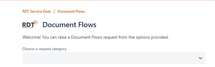

We have created a Project in Jira which we originally called "Document Flows" we now want to change this to "Service Desk".
I have changed the project name everywhere I can find in the backend and followed all the guides, but for some reason the name does not change on the customer front end. We have another project which I have successfully renamed, but this one for some reason will not change.
Anyone know where I can forcefully change this or if there's a field I might have missed.

I went to the page you suggested, The only options I get for "project type" are "Service Desk" which is what it was set to or "Business" I changed it to "business" which removed it from the customer front end and then changed it back to SD which meant it re-appeared but still had the incorrect old name.

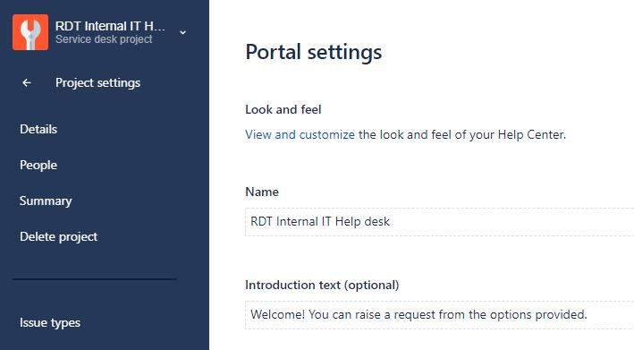

@Jack Brickey thank you but I have tried this.  I made this change last week but it still hasn't updated. It appears to have updated in the back end.
As you can see I have also updated the "Introduction Text" but it hasn't changed in the portal.
I'm sure this is bug but is there anyway to force? I would rather not re-create the whole project but it feels at the moment that might be the only way around this.
