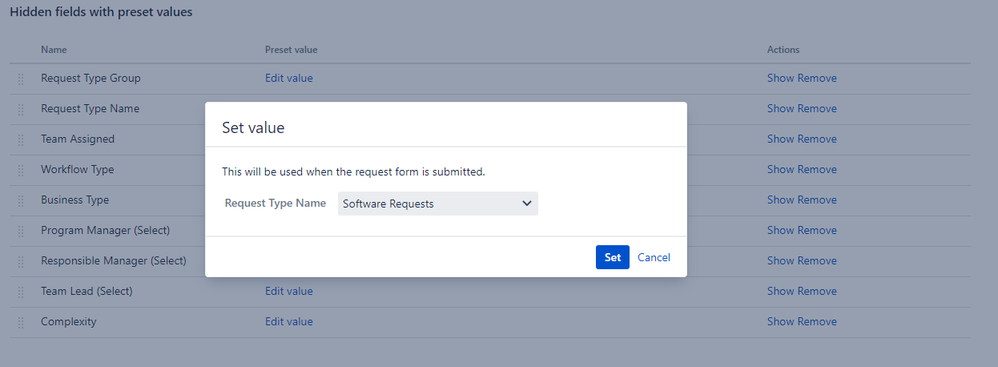

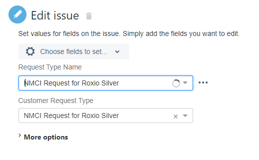

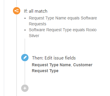

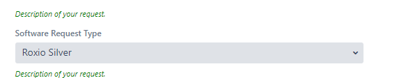

I have created request types, have fields populated, some hidden, some required to choose, and based on a combination of field options chosen, I have a Project Automation rule to set two fields, one of them being the Customer Request Type field, which is set by Jira Service Management, but is also able to be changed.

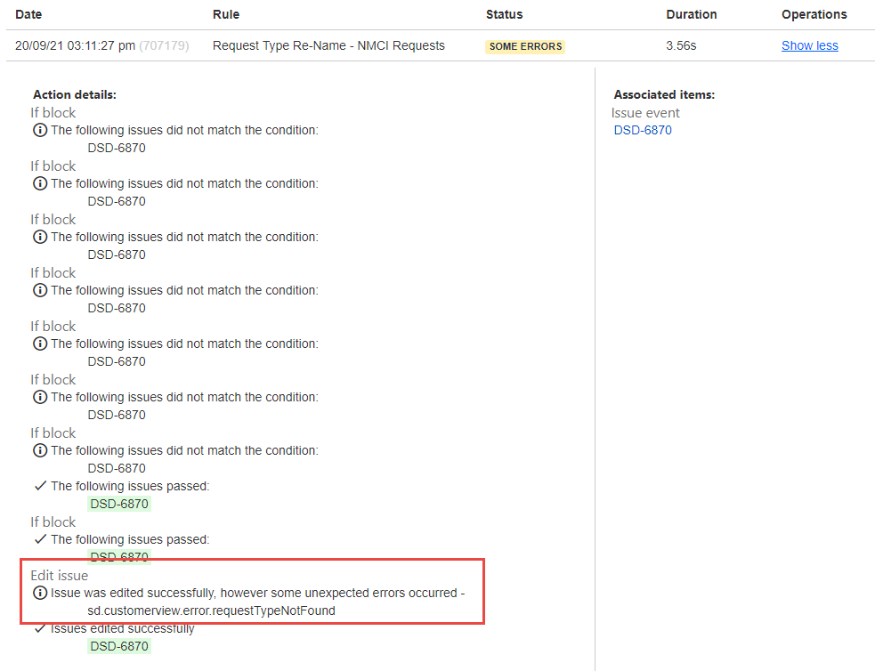

For it to initially work, I had to create "dummy" request types with Request Type names to match the eventual output desired based on the rule. I did that, no problem. When that was complete, I tested the rule and it succeeded. When I delete my dummy request types, the rule fails. Even when I re-create them, the rule still fails. There should be nothing that is causing the rule to fail, but it is.

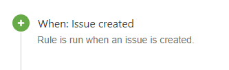

Screen shots added for amplifying details.
Then part of Rule.pngChosen Field.pngDummy Request Type.pngHidden Field.pngIf part of Rule.pngRule Trigger.pngAudit Log for error.png
