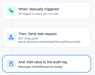

I have established for testing a very simple automation rule as follows:

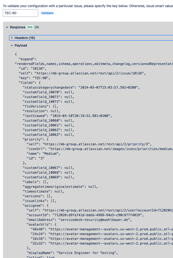

When validating the GET ISSUE request: every thing seems fine, positive response and payload visible (I shortened the screenshot a bit):

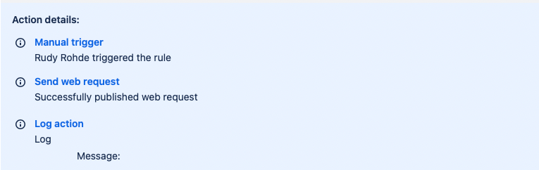

When I try to write the payload down into the Audit log (or a comment in the ticket): the {{webResponse.body} seems to be empty:

Correct syntax is {{webhookResponse.body}}
And subsequently {{webhookResponse.body.key}} or {{webhookResponse.body.fields.priority.name}} etc to reference the fields..

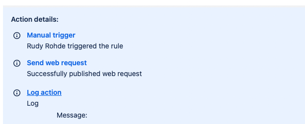

With {{webhookResponse.body}} or {{webhookResponse.body.key}} or {{webhookResponse.body.fields.priority.name}}...still the same result: nothing :(

@Kalyan Sattaluri : YOUR ANSWER IS CORRECT
I just forgot now with the changed to delay the further execution till the GET method completed. Working now

Hmm.  Strange. Can I suggest..
Instead of using smart value in the GET call, for test purposes, provide directly issue key like below and trigger the rule from an issue and log {{webhookResponse.body}} as you were and see if you getting results.
