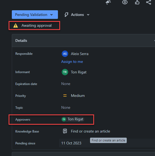

We have an approver field, with the configuration of making the assigned user to set it, but we want to set it with an automation.

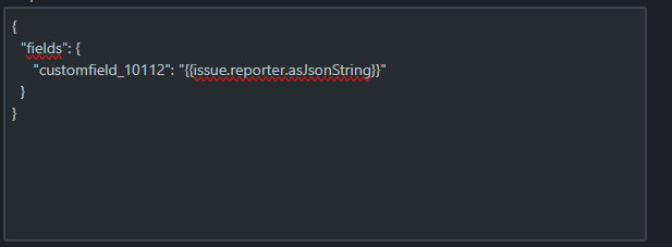

With this code, it seems that works fine:
"fields": {
"customfield_10112": "{{issue.reporter.asJsonString}}"

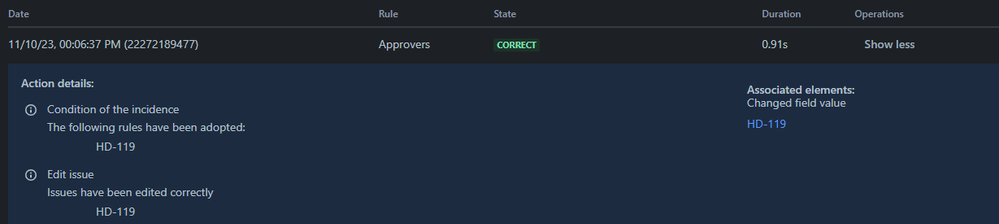

But it does not, it doesn't return an error but also does not update the field:

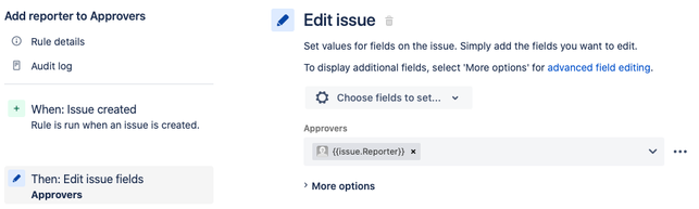

I expect you want the issue reporter to be the approver.
You don't need to use the advanced option, you can use the smart value {{issue.Reporter}}:
Will this help solve your issue?

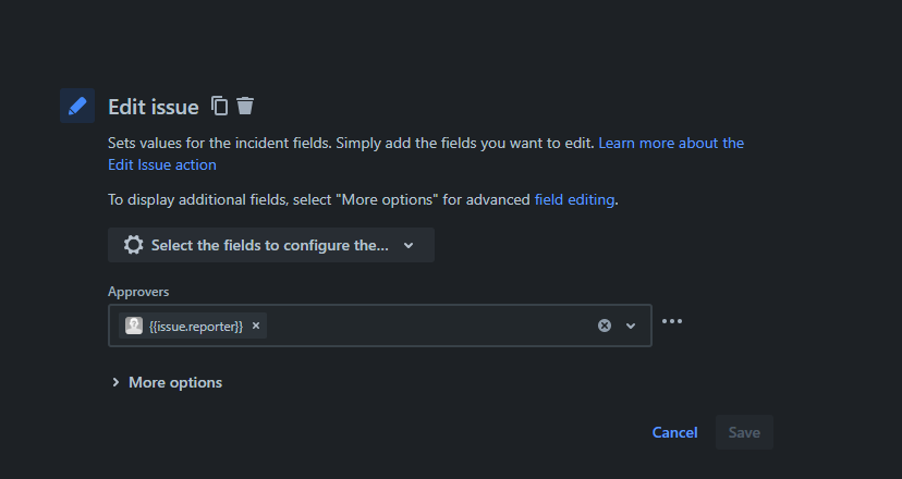

Ton Rigat
October 11, 2023
Thanks for the fast answer.

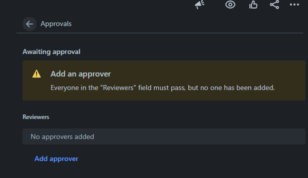

It's not exactly right, it works but not with the same field:
The problem is that the field "Reviewer" does not appear in the list of fields, that is why I was trying to do it with JSON

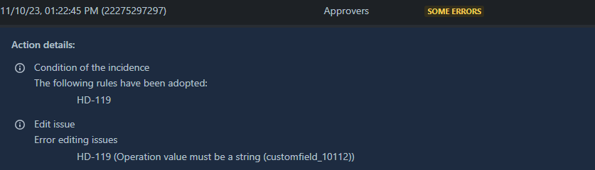

Still something wrong:
image.pngI used both variants: issue.reporter.accountID and reporter.accountID
Both return the same error.

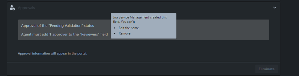

What is the field type of the custom field "Reviewer"?
Ton Rigat
October 11, 2023
It's autogenerated by Jira, I guess it's user type.
