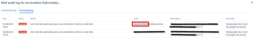

We have a JSM Project with a Customer Portal in witch we want the e-mails replied turn into comments on issues
However we noticed that comments are not being added and we are getting errors on e-mail handler logs regarding to lack of permission to add internal comments
The error says "You do not have permission to create internal comments in this issue".

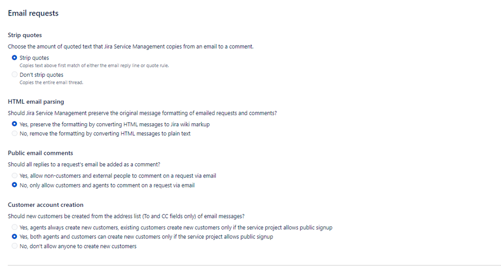

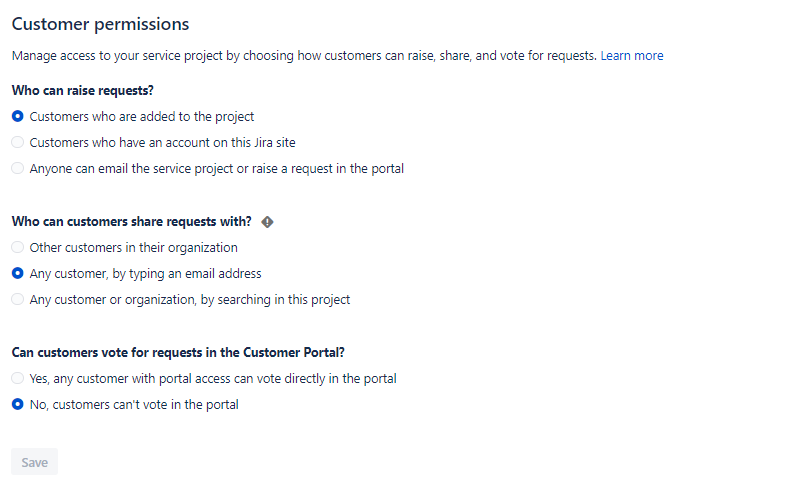

Yes. I have three other Service Management. The difference is that on this one, the customers are receiving a custom notification and they should not have access to the portal (they are not added as customers to this project). I want them to be able to comment but they can't see the issue neither the portal. What is intriguing me is that it worked at the beggining. I might have made some change and it's not working anymore...

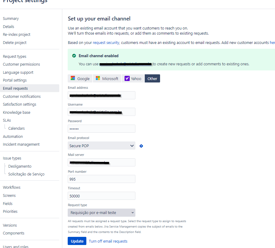

Yes, I'm using the Service Management Mail Handler.
Could you probably share an anonymized screenshot of those parts of the configuration?
Here it goes!

This might be the point. They are not reporter and are not participants too. They should not see the portal nor the issuea. I must make sure they are not added to the project as customer because they cannot see each other comments, as we are talking about sensitive information. It must work as a BCC mail received and only replied to the sender.

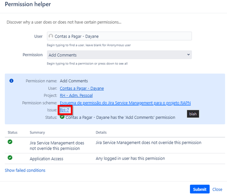

I REALLY don't know what is happening and don't know what to do either.
The permission seems ok:

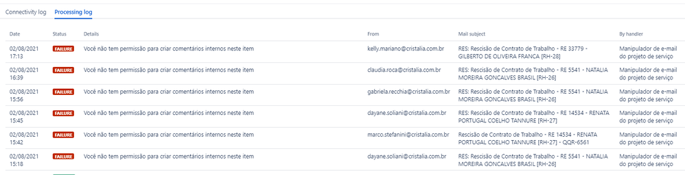

I realized that all my screenshots  turned into the same.
Here are te other one showing the error to the same same the permission indicated ok:
