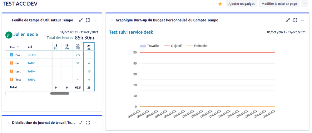

We want to create a dashboard that uses the Tempo Account Personalized Budget Burn-up Chart gadget in order to follow the progress of the budget and the hours of work carried out on a project.
We previously created a Service Project and added support tickets, we also added working hours on tickets using the tempo tool.
At the same time on tempo we created an account and we associated a budget as well as link the project previously created.
Now when we add the gadget in the dashboard, we have the budget inserted in tempo which is indeed active but the hours that we added in the project tickets are not taken into account in the graph (work line).
Thanking you.
Best regards.

Julien Bedia
October 21, 2021
Hi @Susanne Götz _Tempo_
First for all, thank you for your quick response.
How can i find the "Approve Timesheet" permission ?
I admit that i am a beginner in using Jira.
I share with you a picture of my problem.
Best regards,
Bedia Julien
