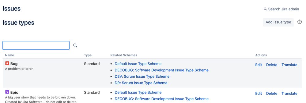

If you go to Issue Types section, see if you have an issue type with the starting with the name Service Request.
If you hover over the EDIT link (see screen shot) it will give you the ID.
You can also look using JQL to see if you have multiple issue types that start with Submit a Request... . The sample screen shot is from my test jira cloud instance.Screen Shot 2020-10-14 at 10.58.14 AM.png
