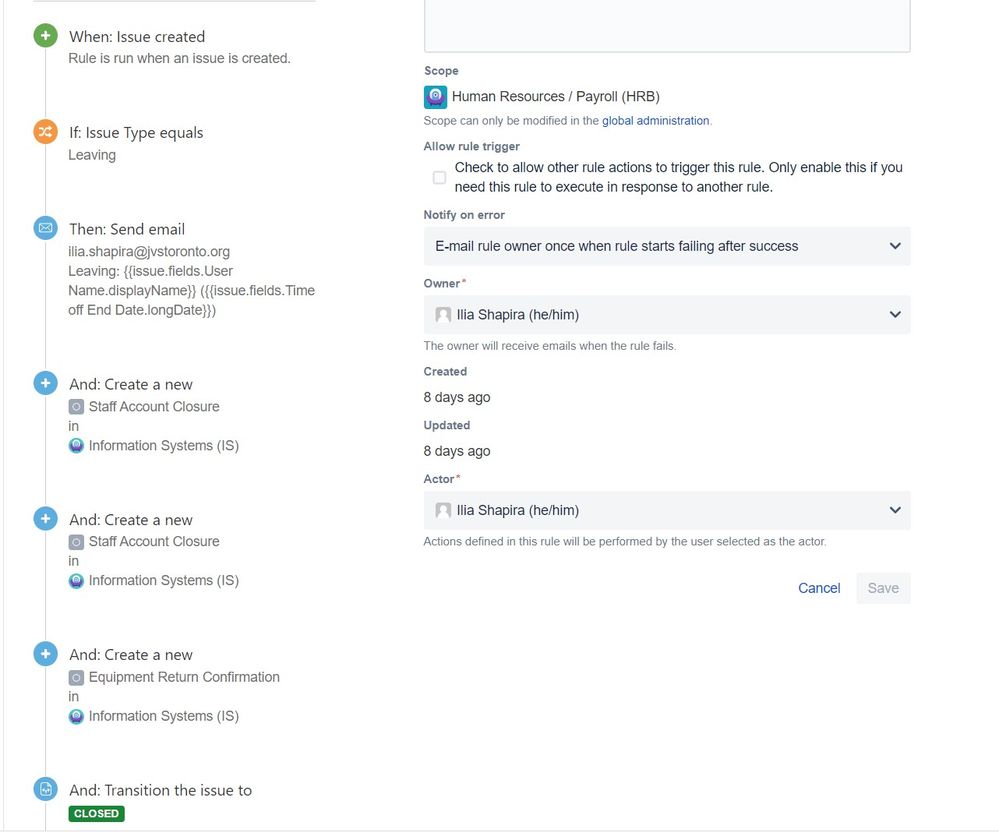

This is the rule

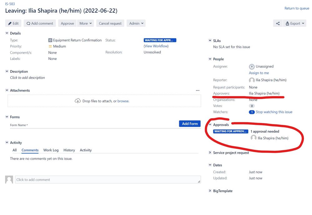

Here you you can see the ticket that gets created. It is assigned to me as approver as it should. But I don't get approver notification and if I go to Customer Portal - Approvals its not there

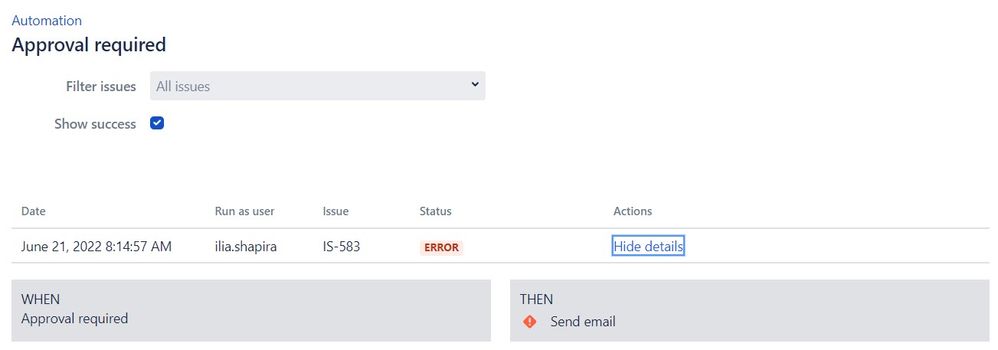

This is an error from  Customer Notification Approvals log

If the IS-583 is created by the Automation Rule, I believe, if you click "Service project request" on the right-side menu, you will see "No match" for the Request Type field.
That's because, in your automation rule, you use Actions to "Create issue" where you won't be able to select the "Customer Request Type". By right, you should select Actions to "Create Service Management request" and select the correct Request Type.
If a JSM issue is created without a valid Request Type, the issue will not behave like a JSM Issue such as:
  • The issue will not be available from the portal. Thus, the approver will not be able to get an approval notification from the portal
  • The approval workflow will not work properly. For example, the approver will not get an email notification
