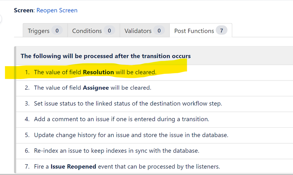

It feels like it has something to do with that I have the Resoultion field will be cleared? :( reopen post funvtion.png

yes, this postfunction clears the date field, and the automation rule only runs after this so the date would be lost by then.
You could do one of 2 things.
  • Add a postfunction copying the date to another (custom) date field for later retrieval before you clear the resolution, and use that custom date field for your mail
  • remove the "clear resolution" postfunction from the workflow and clear it in your postfunction as an action after you first get the smart value.
    (!) I wouldn't recommend this option as it will be difficult to make sure your rule runs everywhere the workflow is used, and those tickets won't have resolution cleared and thus stay "closed" in the eyes of the system.
- Tessa
