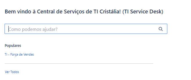

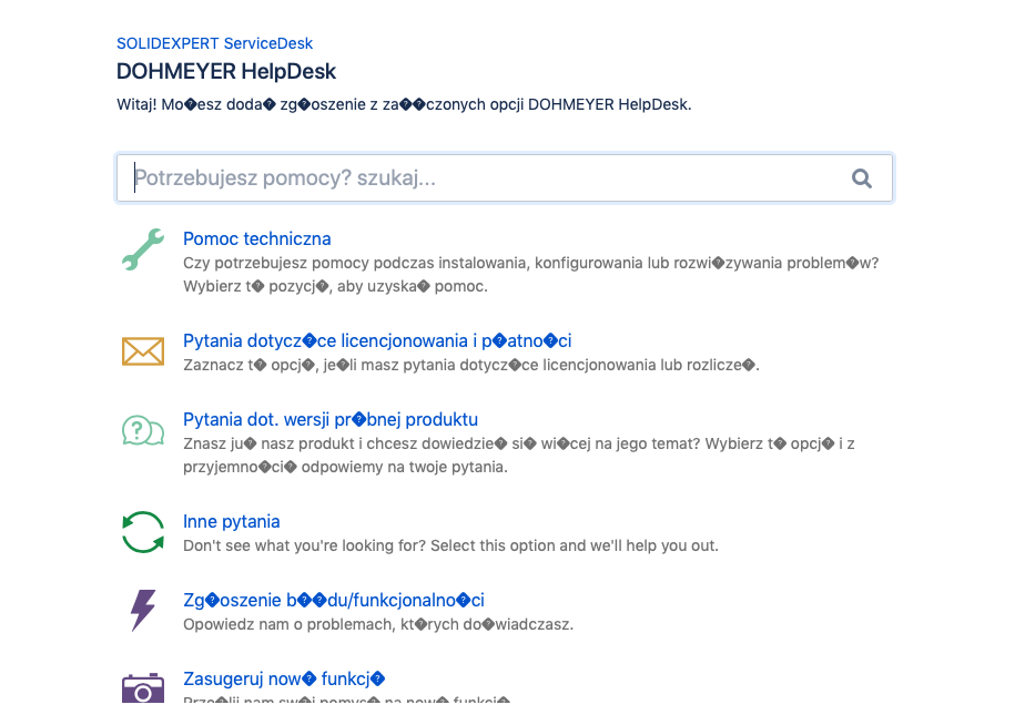

Hi there! After last upgrade to JSD 4.0.0 I have a problem with characters encoding on Customer Portal. There is no polish characters, like ąśćł etc. Before upgrade there was no problem...
How can I fix it?

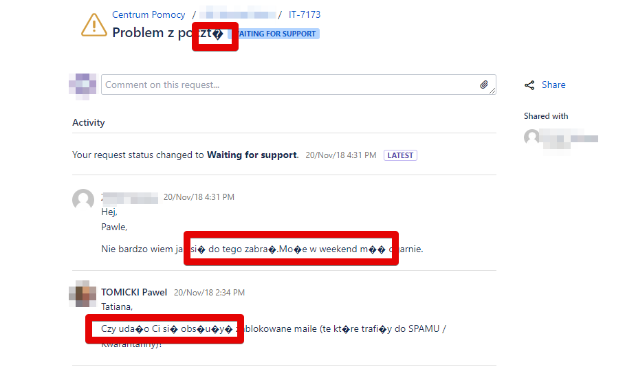

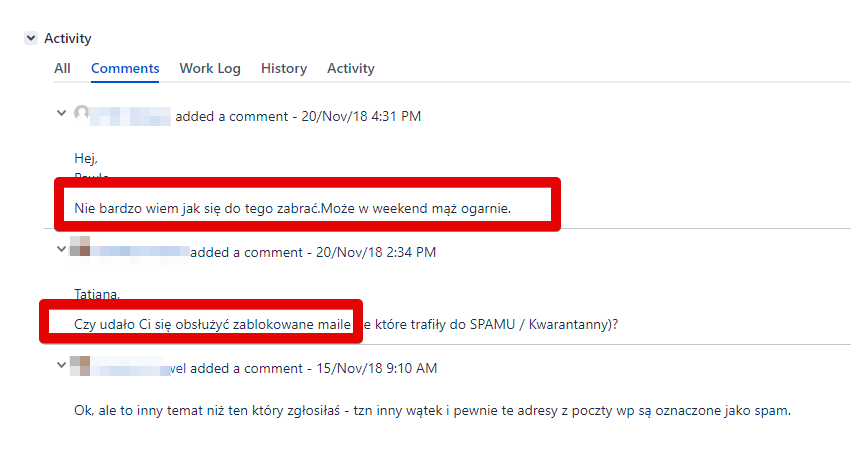

PL_IS
February 18, 2019
Hello,
I can confirm the same issue after upgrade to JIRA ServiceDesk 4.0
Special characters (polish characters) are missing and replaced by ? in "rhombus"
My previous version of JIRA was 7.13, I am using MySQL 5.7 which use UTF-8
mysql> select * from propertystring where id in (select id from propertyentry where property_key='webwork.i18n.encoding');
| ID | propertyvalue |
| 10205 | UTF-8 |
1 row in set (0.00 sec)

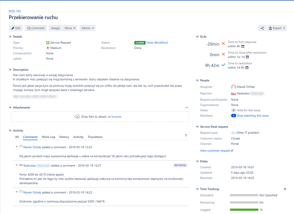

I noticed that this issue is only on customer portal view (ServiceDesk Agent view is valid without missing characters)
Here you can see this thread for Service Desk User (customer portal) view:
Here you can see this thread for Service Desk Agent view:

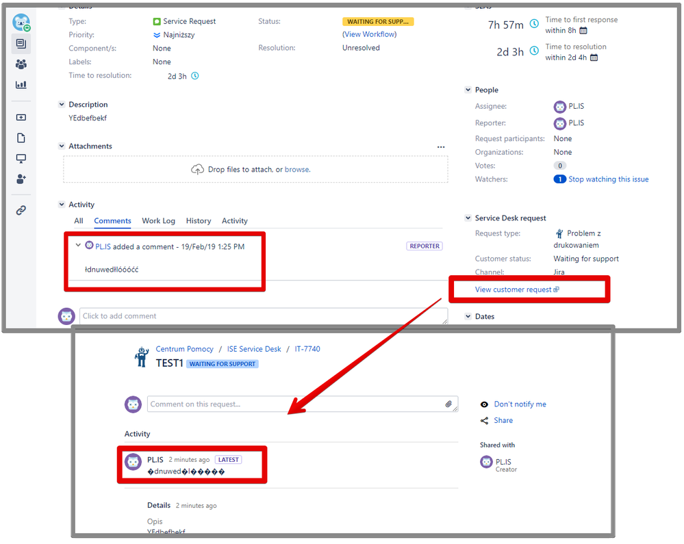

The encoding problem is only when I open Customer Portal View with ticket from ServiceDesk Agent window.
Below you can see two windows on one screenshot as example.

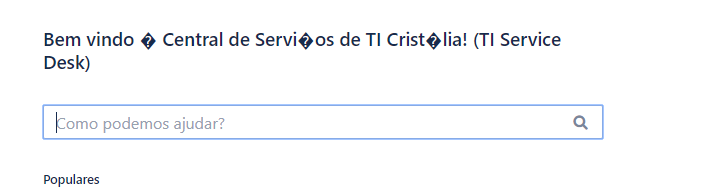

Luciano Oliveira
May 2, 2019
Hi Michall.

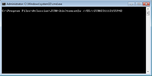

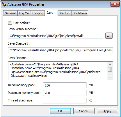

First you need to doo is identify how you start your aplication. For example in my case I use Windows service. After that you need to configure the system properties when starting
1 - Identify the name of the service that JIRA is installed as in Windows ( Control Panel > Administrative Tools > Services ):
In the above example, the SERVICENAME is: JIRA231112155942
2. Open the command window from Start >> Run >> type in 'cmd' >> Enter
3. cd to the bin directory of your JIRA application installation directory.
4. Run:
5. tomcat8w //ES//%SERVICENAME%
In the above example, it would be tomcat8w //ES//JIRA231112155942

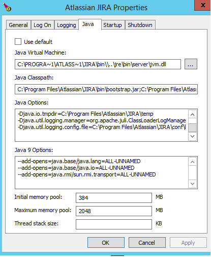

Click on the Java tab to see the list of current start-up options:
7. add this option in "Java option":
-Dfile.encoding=utf-8
-Dsun.jnu.encoding=utf-8

We are starting JIRA as a win service. I followed the steps above and added -Dfile.encoding=utf-8 and
-Dsun.jnu.encoding=utf-8 to Java options. After that we were unable to Startup JIRA again, even after rebooting JIRA server - we get Error 1067: The process terminated unexpectedly. We are running Windows Server 2012 R2, JIRA 8.1.0, Java v. 8 update 111 (build 1.8.0_111-b14), database MSSQL 2012.
Can be the reason low memory? As you can see in picture, we have allocated max. memory pool for Java 2048 MB and Tomcat8w process uses the same amount. Our virtual server has 8192 MB.
Norbert Farago
May 2, 2019
Hello,
Just checked those memory settings in my dev server and Jira starts fine with it.
Please check catalina.[date].log, it should contain the error why it failed to start.

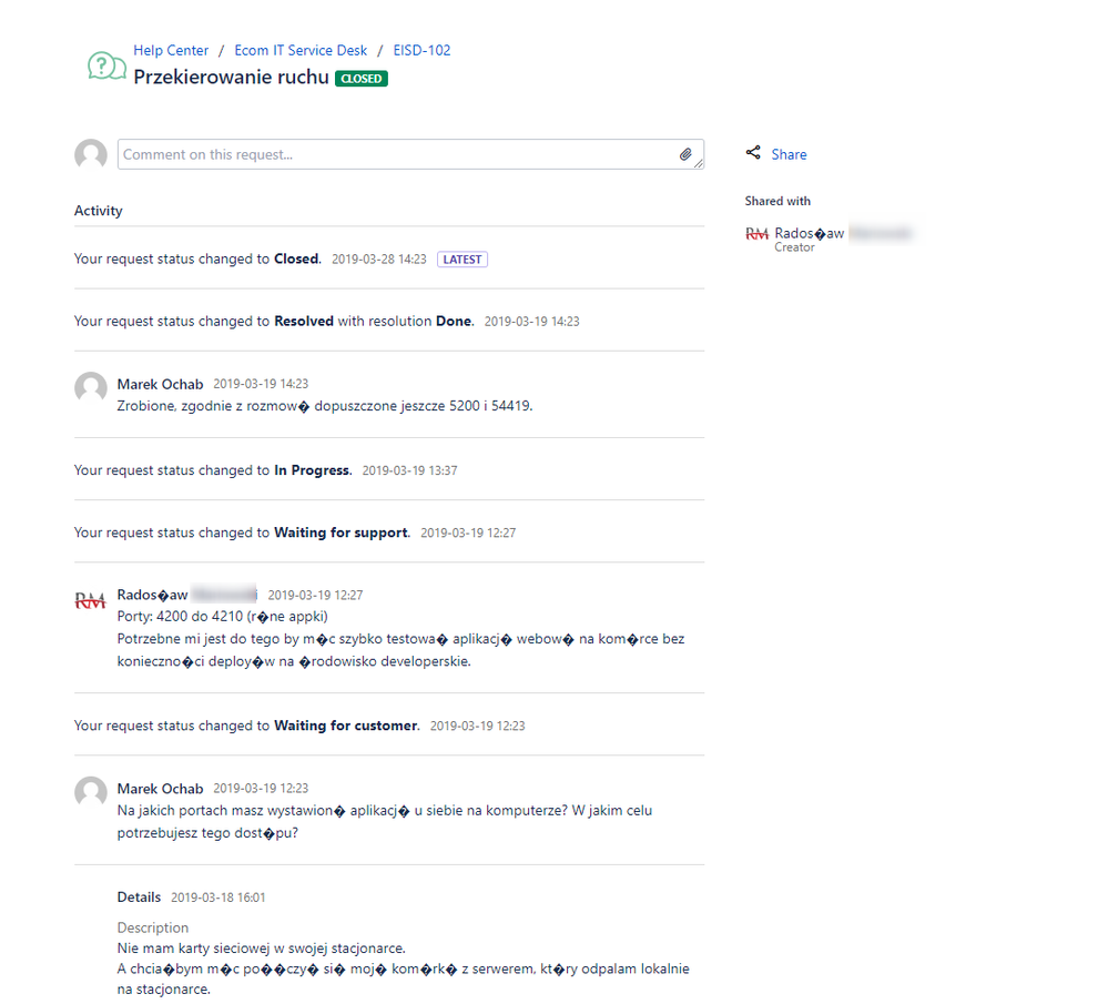

ebusinesspl
April 5, 2019
I got the same problem but in 3.16.1 version. Jira and Jira Service desk is installed on the same instance. There is only problem with encoding polish characters in service desk portal. I suppose that this issue has been showed up after some upgrade Jira/JiraSD.2019-04-05_15h42_29.png2019-04-05_15h42_46.png

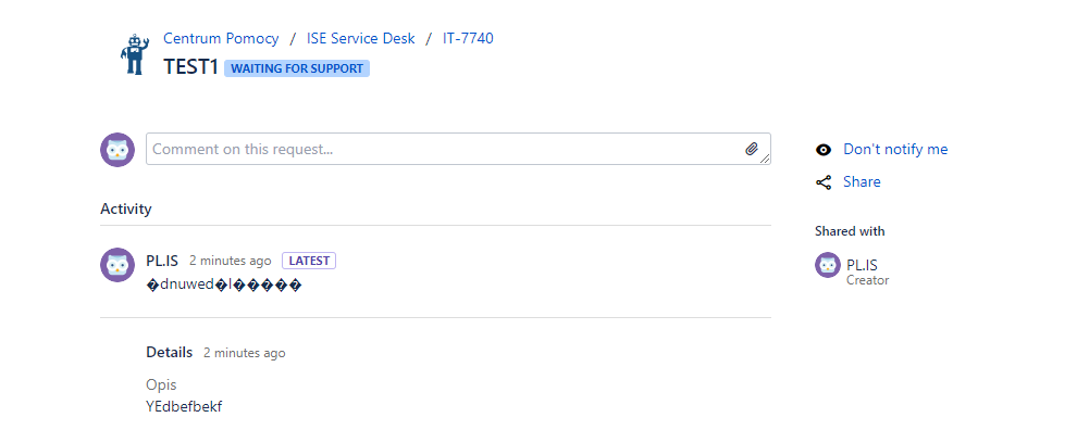

PL_IS
February 19, 2019
Hey Mateusz,
I tried to implement your solution, but without positive results. :-(
I did also some tricks with MySQL enconding for database according to Dave recommendation - no positive results too  :-(
Some times the best solution is to start from begging so I tried to install JIRA ServiceDesk 4.0 (Core 8.0) from scratch.
  1. I droped jira database and create it from scratch like is described in this Connecting Jira applications to MySQL 5.7
  2. Then I imported backuped database (exported from production enviroment which works on JIRA 7.10)
It didn't resolve my problems with encoding custom portal but I noticed some new thing.
The problem is with encoding only when I try to open Customer Portal View (window) from ServiceDesk Agent portal like on screen below:
[IT-7740] TEST1 - Lyreco JIRA 8.0 - Google Chrome 2019-02-19 13.27.52 (1).png
Do you have any ideas what can cause this issue?
