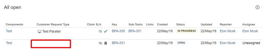

However, when going to the queue to see all open tasks, this newly created sub-task does not have a value associated with the "Customer Request Type". The "Customer Request Type" is used by the teams to do the actual work associated with the task. Since no value is placed in this field.

Sub-task-no value.jpgno one can determine who needs to do this work.

There's a structural problem here.  A request in Jira is represented in the back-end by an issue.  A customer has a single request, and Jira is written to handle it via that single issue.
Sub-tasks are part of the issue, added by internal users and hence not directly related to the request type.
My instinct, if I had been Atlassian, would be to cascade (read only, of course) the request type down to the sub-task from the parent, as it can be useful.  I can't see any reason not to do that.  But Atlassian have not implemented it.  I don't know why, but I'd guess because people would demand all the rest of the request information as well, which is even more code, and the easier answer is "go look at the main issue, sub-tasks are for you to just break it up a bit"
Of course, if you do "fix" it, you're going to need to be able to explain to users why the Service Desk gives them different numbers to Jira.  Think about the question "How many Requests did we handle last week?".  Service Desk might answer "80", and Jira "320", because you added an average of 3 sub-tasks to each one.
