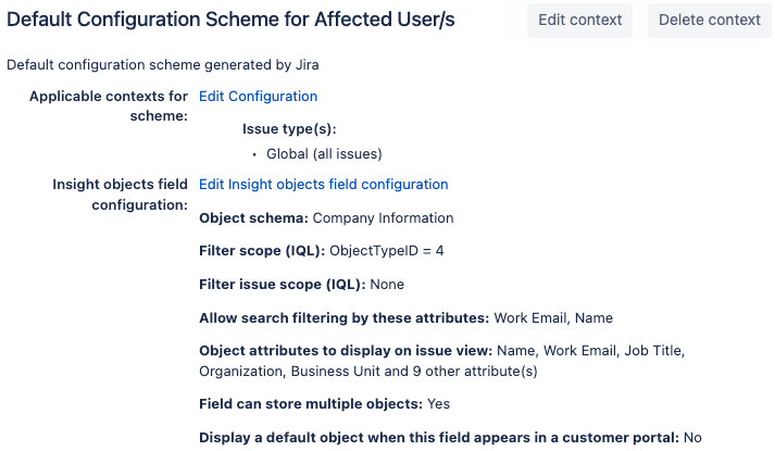

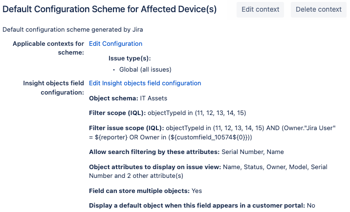

Field configuration (devices)

Field configuration (users)

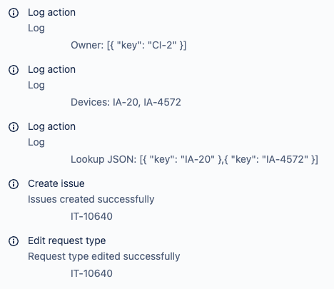

Jira Automation logs (final result is success). Each field returns de expected results

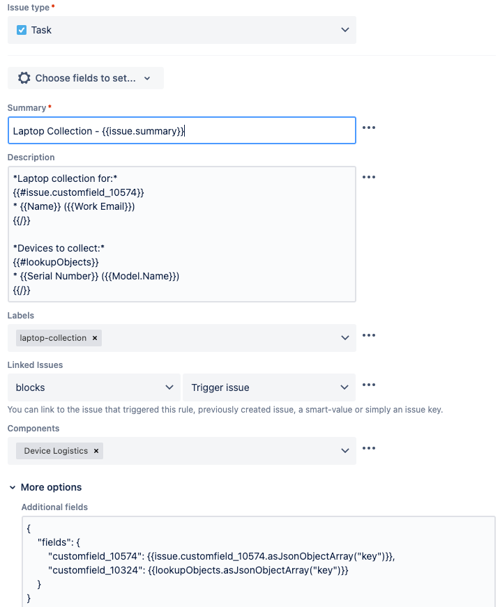

Automation step to create new ticket with data from parent + insight objects

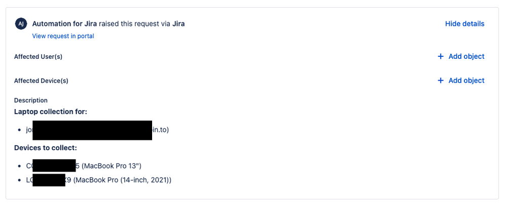

Example of ticket created by automation. Description field gets values correctly but both insight object fields are not populated. Similar fields get assigned properly setting the value through the automation fields instead of the custom "additional fields" JSON.

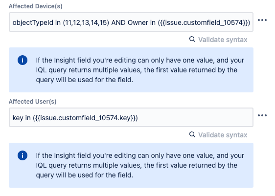

It was easier than I thought... I got confused by the blue banner next to the fields and somehow I thought that I couldn't use this method to populate multiple values... I did now read it twice and give it a new try and worked perfectly!

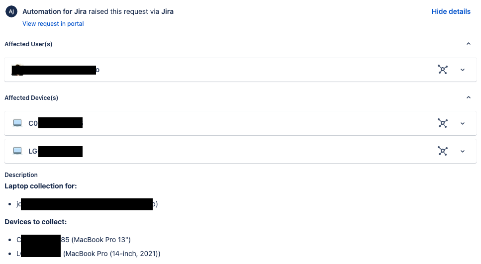

I was able to do it within the issue creation field without an extra step (edit). I have a issue type edit step after the ticket creation anyway...
In your case maybe is because it doens't have the right issue/request type on the ticket creation and the fields you are trying to edit are not available yet?
In any case, thanks so much for your input here. I've been smashing my head against a wall for some good hours...
