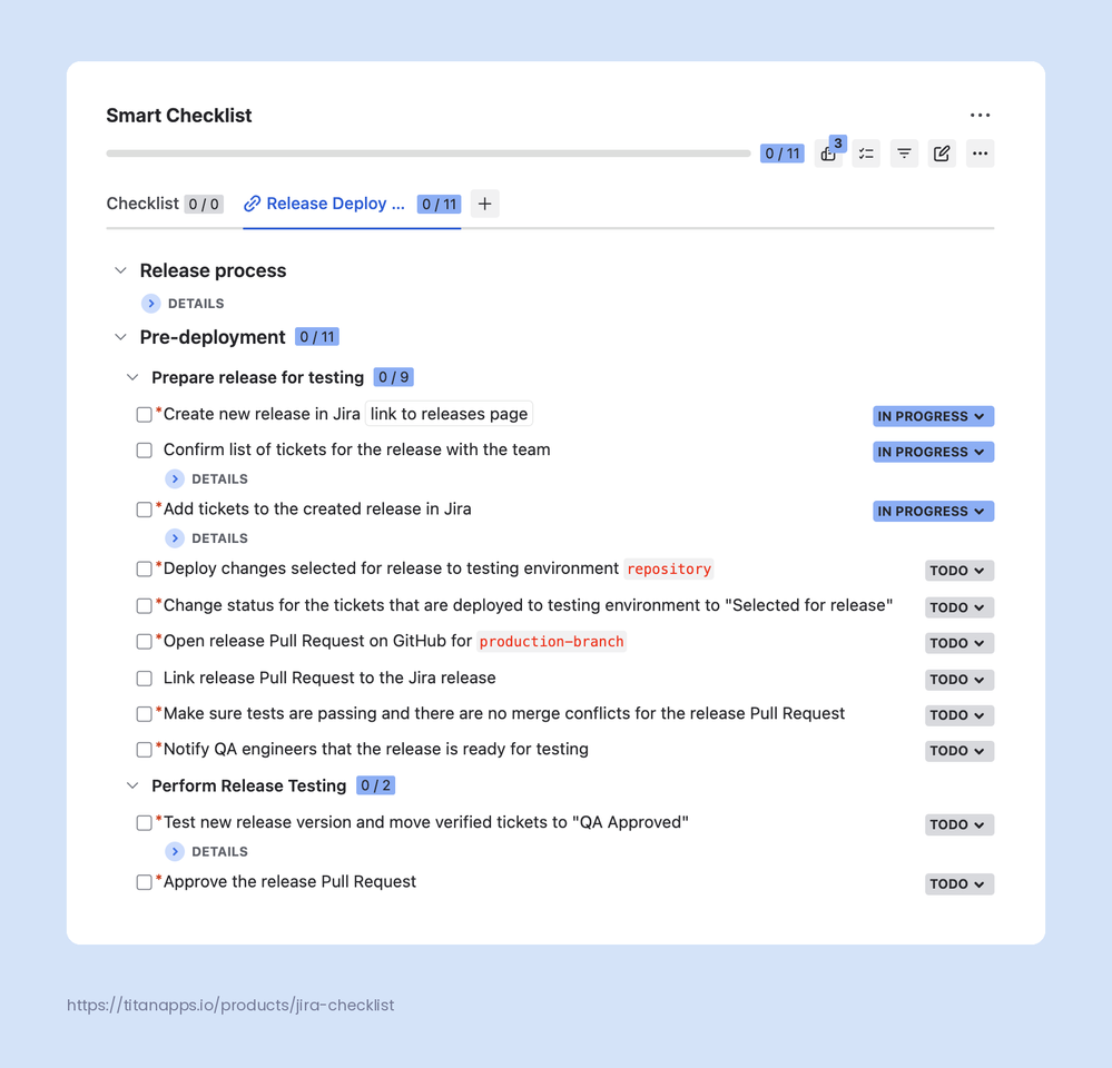

If you need real enforcement, you'll need to move that procedure into something the workflow can read. A dedicated checklist app is usually the cleanest fit. In our own JSM setup, we use our solution Smart Checklist for Jira.
The relevant piece for your case is the mandatory items feature combined with a workflow validator - you can mark the critical steps as mandatory (via the Markdown editor or through the UI menu), and the validator won't let the ticket move forward until those specific items are checked off.
A few practical notes that might save you time:
  • You can apply the checklist automatically to new tickets based on request type, so agents don't have to add it themselves
  • Marking only the critical steps as mandatory tends to work better in practice than enforcing the entire list. Agents still see every step, but the gate is reserved for the ones that genuinely matter
  • If it's useful for your process, you can also make checklist progress visible to the requester on the customer portal, so they can see where their ticket stands without having to ask. Entirely optional, but a nice touch for transparency

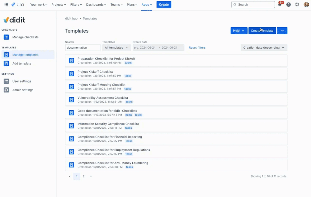

If this behavior is important to you, and if you're open to a Marketplace app, I'd suggest looking at Didit Checklists. Full disclosure: I am affiliated with the team that built this app.
What Didit does differently is that the checklist itself becomes the gate. You define a checklist template with the steps agents need to complete (similar to what you'd put in a Playbook), attach it to the issue (manually or automatically via Jira Automation based on issue type, project, or other conditions), and then configure a workflow validator that blocks the transition until all checklist items are marked complete.
This gives you the structured step-by-step guidance of Playbooks combined with the enforcement you're looking for at the workflow level. You can also auto-attach the right checklist template to new issues so agents don't have to think about it.
