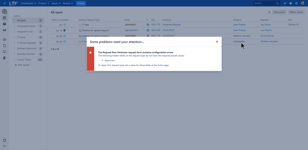

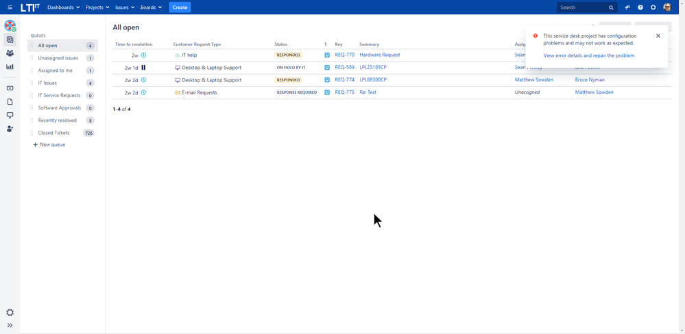

2. I've attached some screenshots below!
3. Yes, check the screenshots (When you see them, please note that I've already deleted the Request Type that was giving the error, which means I have no recourse right now to try and fix this)

If I understand your situation here, you have deleted the request type that is causing this warning to appear.
However I am curious to see if you can click that link in the first screenshot to the 'fields' page.   My thought here is that perhaps you have another request type in question that might have the approvers field listed as both hidden and required.  If that happens, those fields need to have preset values or other wise the customers in the customer portal can't possibly complete the fields need to create requests.
Does that fields link take you to edit a different request type?  Or does it take you elsewhere?
Andy
Matt Sowden May 1, 2019
That was it! It took me to another page with another completely different Request Type that had the same hidden field that was also misconfigured.
