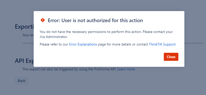

Hello people!
On the Issue Search page is possible to export the resultset with ProForma forms.
But ths feature only works for users that have permission to administer the project.
For users without that permission the following message appears when we try to export the report:
have anyone seen this problem before?
Thanks in advance!

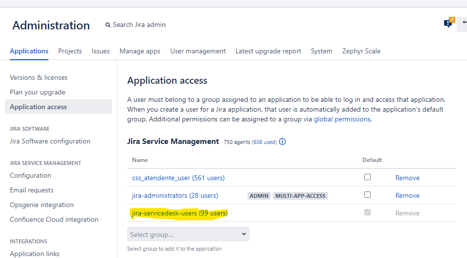

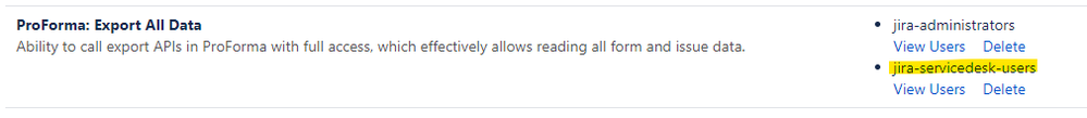

Marcos Strapazon
December 1, 2022
Hello Joseph! Thank you for your quick reply!
In fact I knew about this permission configuration and I enabled the user's group to export ProForma data as follows:

Global permission configuration:
but, even with this configuration, the user cannot perform the desired operation.

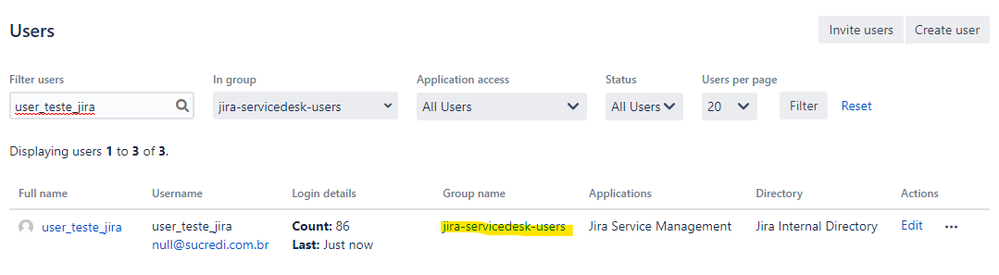

Marcos Strapazon
December 2, 2022
Hi Joseph!
yes, the user is licensed:
